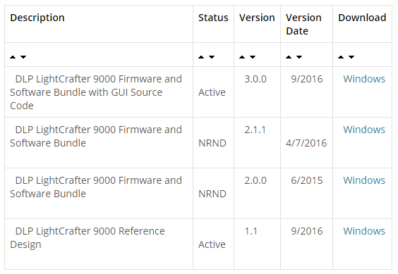

  • Hello Jihee,
    You will need to download the Firmware and Source code for your EVM which is in C++ from the DLPLCR9000EVM page:
    Choose the top item in the table.
    You will then want to also download the Programmers guide from this page:
    http://www.ti.com/product/DLPC900/technicaldocuments - scroll down the the "User guides" and select the top item.
    You will need to build Labview code to wrap around the C++ functions.  There is no already built MatLab code for this.
