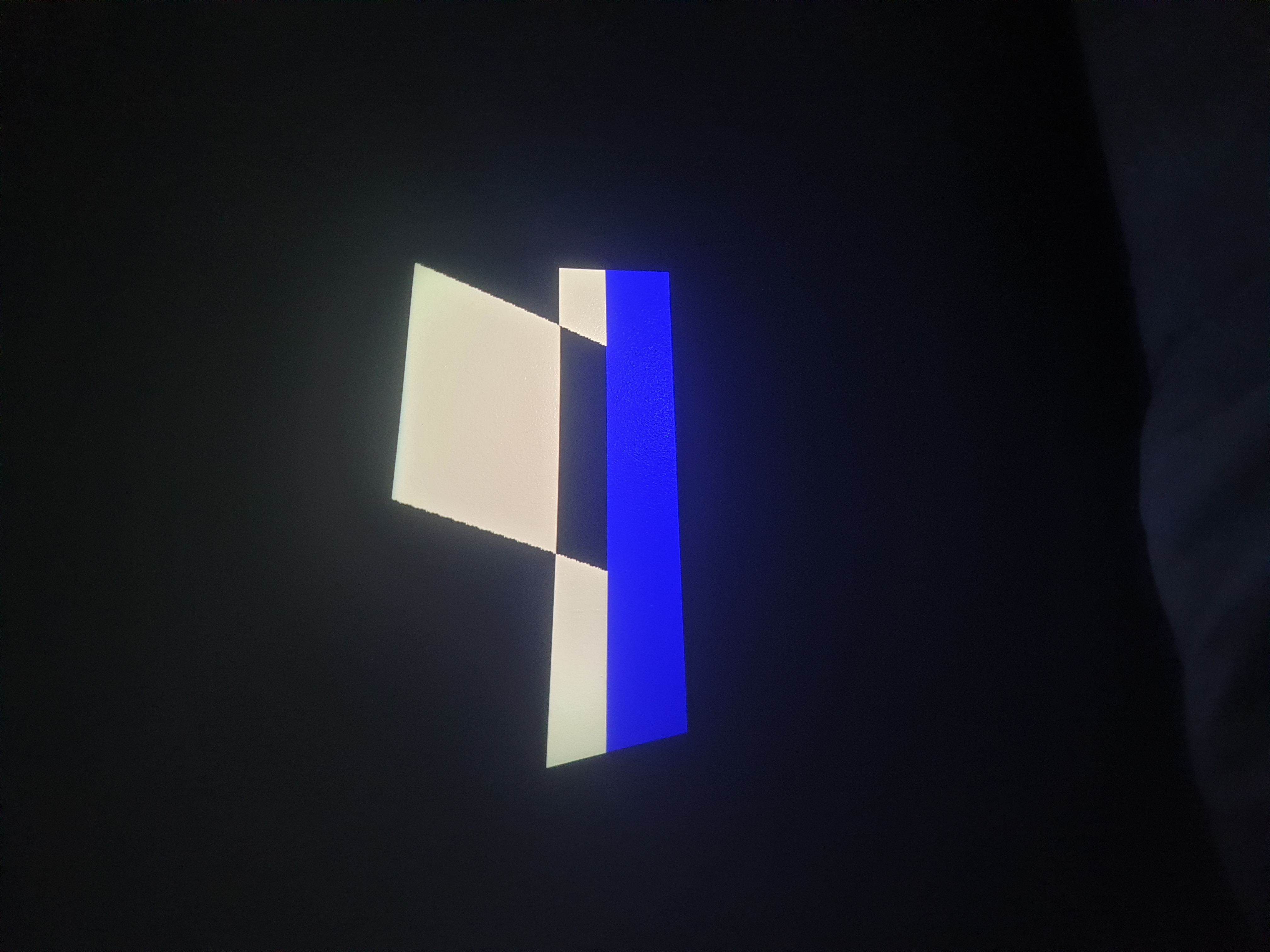

Hi, I'm using dlp2000 to project an image via hdmi controller which outputs rgb888. I sent commands for input Source + Input Resolution + Output Format but I don't get any image output, it just stays on splash screen.
If I send command to display  a set of internal pattern, It displays the internal test patterns but I get a blue stripe at the bottom end (see the image below), if I send the command to change the display back to splash  screen, it will not change to splash screen and will stay on internal test pattern.
I also tried using it with bbb but the evm won't boot and d2 light will stay on.
