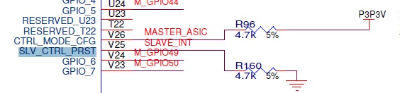

Pull down register for SLV_CTRL_PRST(V25)
Part Number: DLPC900
Which is correct register's value? "4.7kΩ" in DLPLCR6500EVM schematic or "10kΩ" in DLPC900 datasheet?
