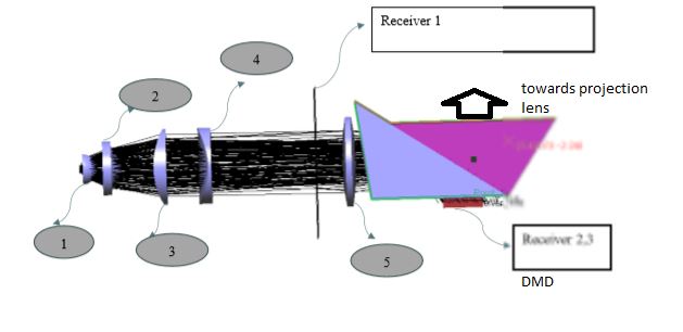

  • System modelled in light tools

  • Hello Vivek Sir,
    I can do greyscale correction.
    But I am already getting a uniform illumination at dmd (uniformity of about 85- 91%) since have truncated the beam.
    My real question is
    The system designed as above using cylindrical lens patterns generates an uniform illumination at dmd.
    But I am not using any homogenizer, so will this result in loss of image quality.
    Is homogenizer an absolute necessity if i can compromise on efficiency?
  • Hi Tanmay,
    I do have few follow-up  questions:
    1. What type of illumination source you are using?
    2. Where is DMD in the simulation model ?
    3. Is there  a projection lens in the model or outside?
    4. Cylindrical lens does allow to change the aspect ratio of light source to match with DMD. What is your criteria for image quality?
    regards,
    Vivek
  • 1. What type of illumination source you are using?
    LED uv monochrome CBT39 by luminus having FWHM of 130 degrees
    The DMD is placed below the prism
    I have simulated only illumination (nonsequential) model so the projection lens will be outside.
    We are planning to directly purchase a pre-designed projection lens with mtf according to TI standards
    For us, brightness and uniformity is the biggest concern as its end use is for 3d printing, we are currently using a light engine which has a total output power of 1W and a uniformity of 90 %, we need a similar light engine.

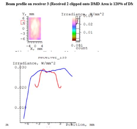

  • The image below shows the power distribution
  • Hi Tanmay,
    Thank you for sharing detailed information. This is helpful.
    If you are getting required uniformity at DMD with some margin then it should be OK. The harmonizer does not impact image quality especially in your application since it is monochromatic.
    Only open question is - How are you modeling LED? Hope you are using real ray set data from Luminus.
    The image quality will depend on the air gap between prisms and projection lens.  Please ensure that the projection lens is designed for the prism  size and type of material used for prism.
    regards,
