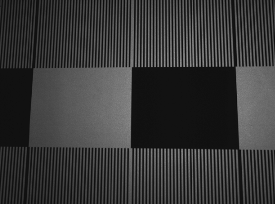

Hi Derlin,
Can you please try by flipping the pattern and see are you seeing the shifted pixel on the same side ?
Navneet

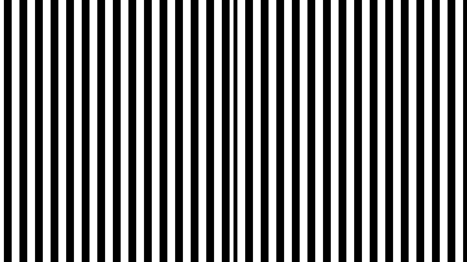

Hi Navneet,
Please see attached screenshots showing two similar patterns (white to black/black to white except center thin black line ) and their projection respectively.
The lower image of each screenshot is image (or pattern) 2 and the upper is image (pattern) 3. Let's look at pattern 2, the number of wider bars on the right hand side of center thin bar on the pattern file is "15", but projected pattern shows "16". The number of wider bars on the left hand side of center thin line on the pattern file is "16", but projected pattern shows "15"
I believe EVM starts the patter in the center of the image and causes the pattern shift in half. This does not happen to horizontal bars since it makes no different where to start for horizontal patterns.
In addition, I read through many posts on this forum, I think my problem is same as below post
Thanks!
Derlin

Hi Derlin, and Navneet.
I think it is not shifted, but merged with other pattern, maybe the next one.
I have very similar issue, sometimes EVM resolved itself without any answer :)).
Now I am facing with mixing patterns as attached picture:
Some phenomenons I observed:
1. Only vertical and horizontal patterns => Works fine
2. Mixing with Diagonal pattern => got above issue
3. Generating Bin file:
- Only vertical and horizontal patterns (I have 34 of them in total): firmware Bin file size: 1.4MB
- With above Bin file, add diagonal pattern (8 patterns more): firmware Bin file size: 4.5MB
All patterns are generated in 1bit format, file size is 129kB.
I dont understand why it happened in this way?
Any input for this issue would be appreciated.
Thank you.
Best regards. Bui Quang Lam
By the way, it displays perfectly if I use DLPLC4500 GUI software, the issue just appears when selecting and display patterns in my program.
