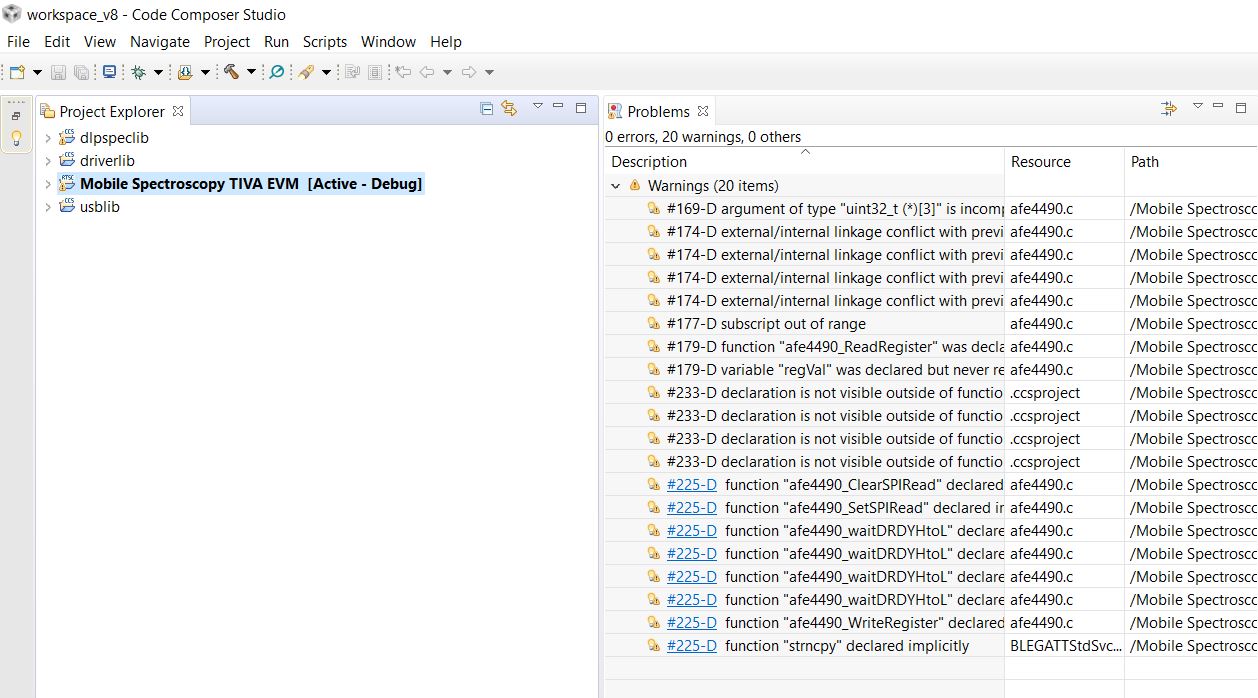

    I have installed the compiler and now the driver and usb libraries work without warnings. But the TIVA EVM MOBILE continues with the same 21 warnings.

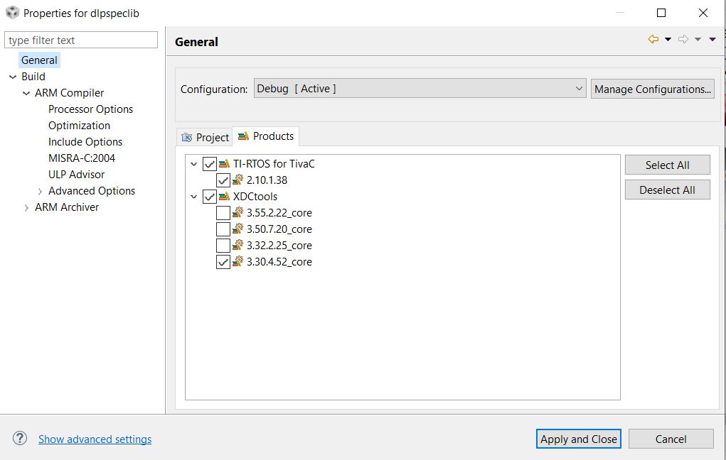

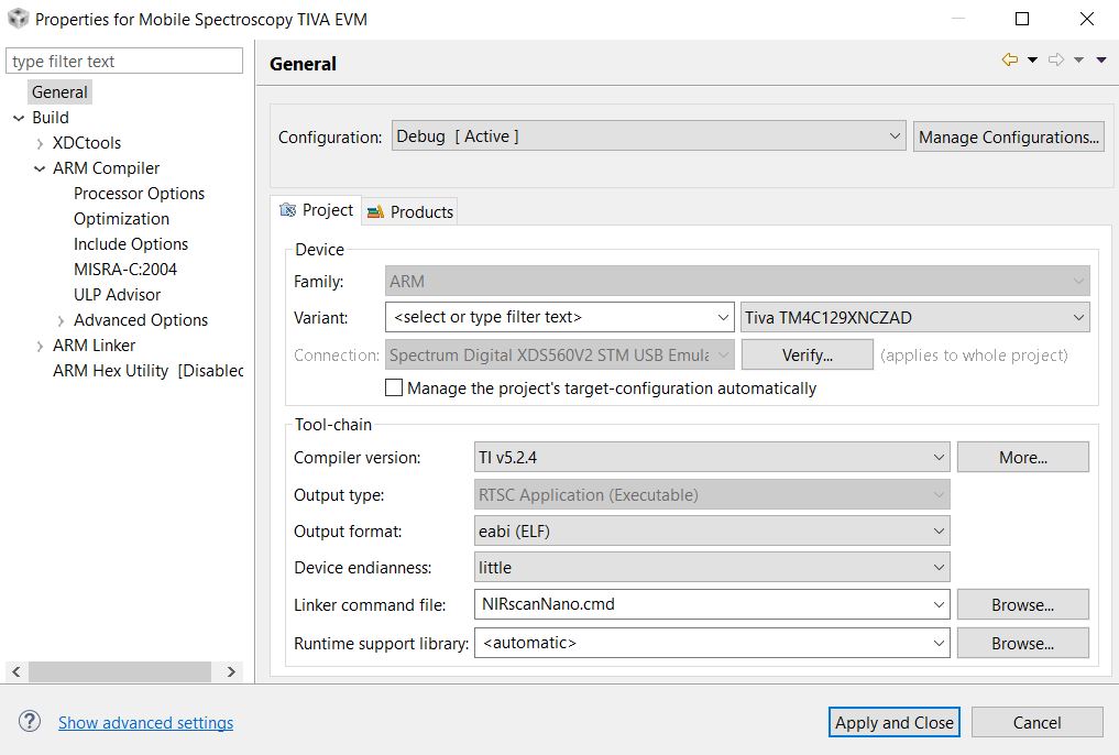

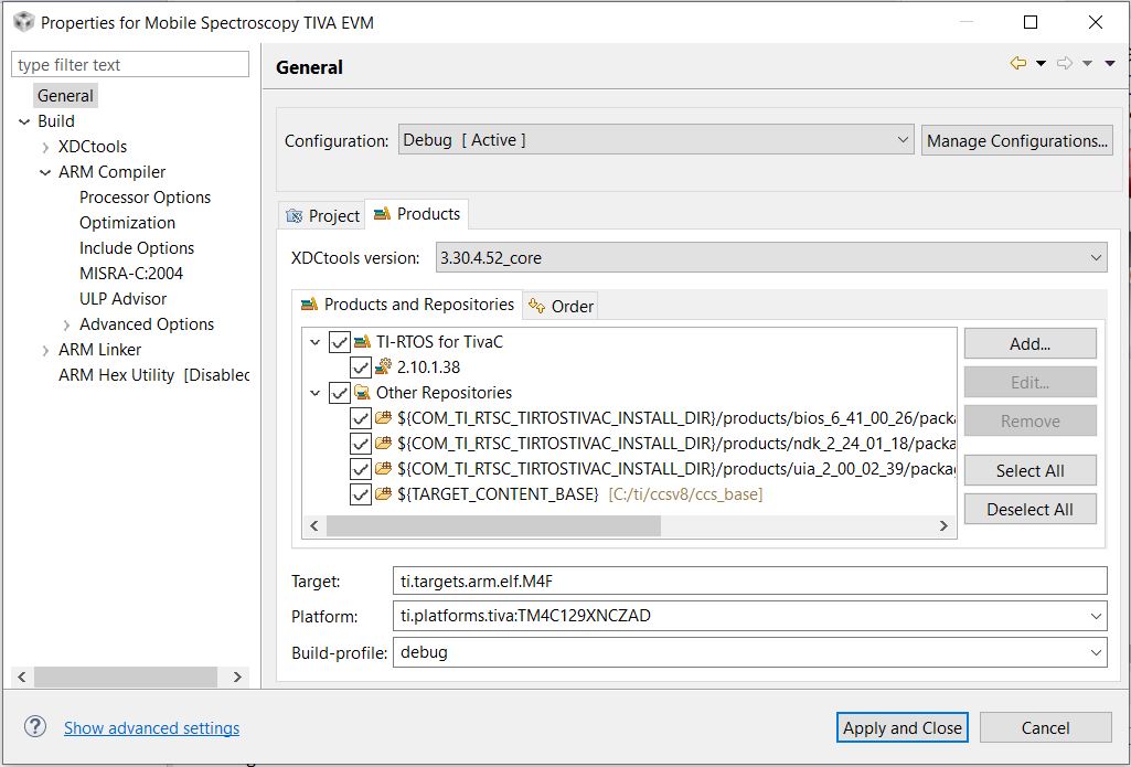

    Which version of CCS are you using? Could you kindly try using CCS v8.1.0 and see if the warnings go away? In our system we have compiled using CCS v8.1.0 and found no warnings. Kindly also ensure that the Compiler version is TI v5.2.4 or later, and under CCS General, select the RTSC tab. Ensure that TI-RTOS for TivaC is set to 2.10.1.38 and XDCtools version is 3.30.4.52_core for all 4 projects.

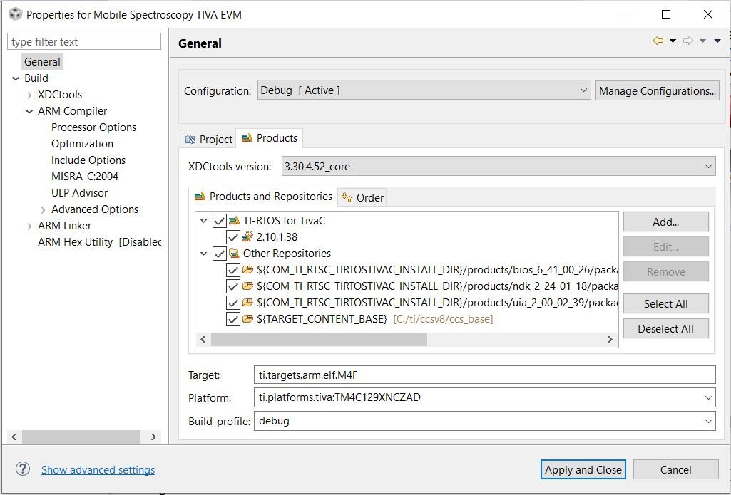

    But I have installed version 8.1.0 as you told me, and I still have the same problems. I have made sure that I have the correct versions of TIVA and TI-RTOS and it is like that.

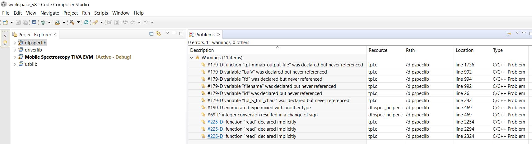

    The speclib have the 11 warnings like using CCS 9.1.0.
    Guillermo
    The dlpspec library have this warning... I forgot to attach that image

    Testing on another PC I have the same problem. 11 warnings in the "dlpspeclib" and 21 warning in "TIVA EVM" ...
    I think that the Spectrum's library is corrupt or something. Because "usblib" and "driverlib" compile without errors, but "dlpspeclib" already has 11 errors before importing the "TIVA EVM".

    I verified the version on TI.com, and it seems that these warnings are present in the project. For now you can ignore these. I will also verify with our SW expert and reconfirm this.
