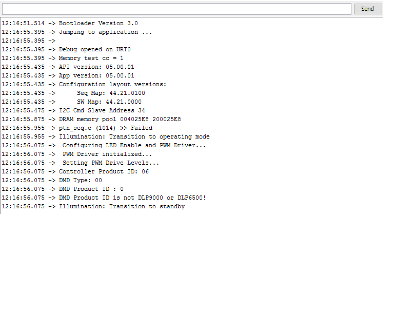

we just bought a DLPLCR6500EVM from DigiKey but we cannot make it work.

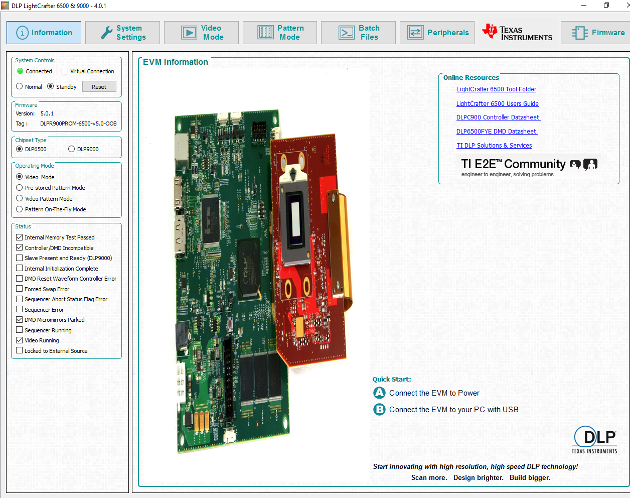

As you can see in the following picture, the board is in standby mode and cannot be switched to normal mode. Besides,  the status error 'Controller /DMD Incompatible' is raised:
Following similar threads, we tried to:
- Test different USB cables
- Re-upload the firmware following these instructions (both with and without jumpers J3 and J11)
Any ideas on how to proceed?
