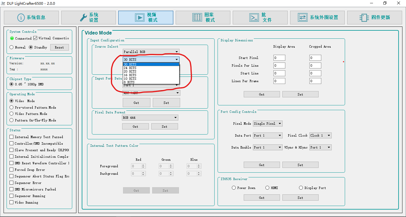

Is the frequency and duty cycle of the pins of DLPLCR6500 EVM external light source adjustable? What is the maximum frequency adjustable to? How to adjust? What does the red circle refer to in the picture? Thank you!

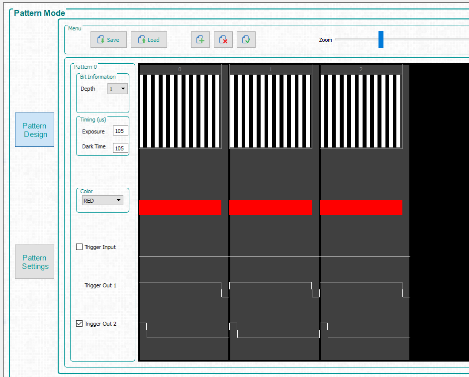

    Is the frequency and duty cycle of the pins of DLPLCR6500 EVM external light source adjustable?What is the maximum frequency adjustable to? How to adjust?
    If you are referring to LED enables which control the light source, you can adjust the frequency and duty cycle by varying the exposure and dark times of the pattern. The LED enables are set during the exposure time of the pattern. You have the option of selecting the color, frequency and duty cycle of your choice. The limit being 105us as the minimum possible enable time for each LED.This can be done by going to pattern mode page of the GUI
    Below is an example of dutycycle 50% and period of 210us which has the max possible frequency of 4.76khz
    The options provided sets the input bitdepth of the image to the input parallel port if you are using a parallel source. If you are using the TI provided EVM, you need not worry about these settings as the HDMI decoder in the EVM provides these inputs automatically
