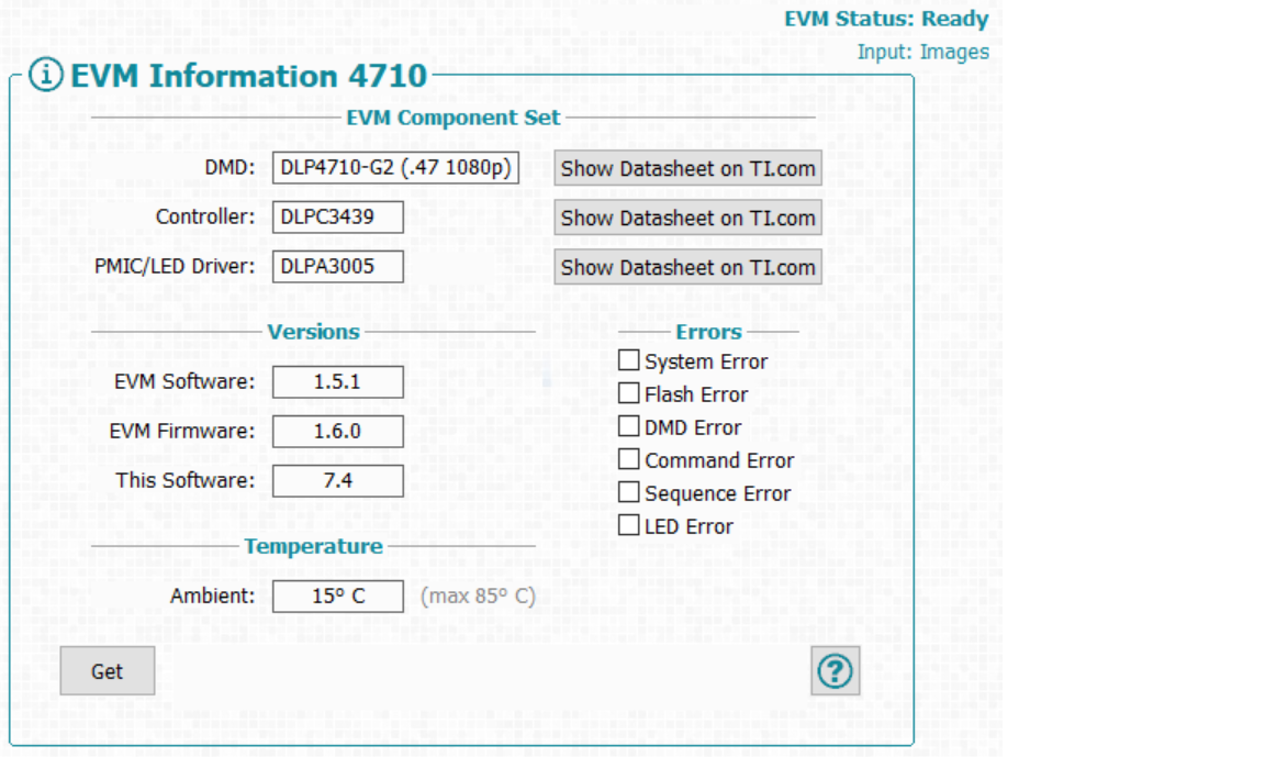

  • Hi Hirak,
    The current version is:
    EVM Firmware: 1.6.0 (first figure)
    I downloaded the newest version (DLP4710-G2-FW: DLP LightCrafter 4710 Gen2 Firmware) 7.3.2 and uploaded it on the device.
    There is no change yet. It still showing no image. It just flashes the image for short time (< 1 sec) and then the image disappears.
    previous version information:
    Currently:
    No change in the output:

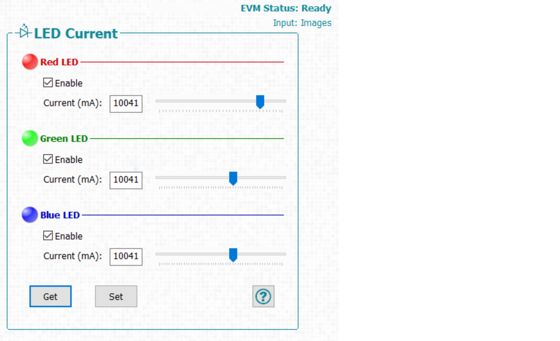

  • Hi Lait,
    if communication is alive, can you check the LED current and LED enable status in GUI. Also can you try change the display patterns.
    Also check the DMD flex cable is tight and intact.
    Nvaneet
  • Hi Nvaneet,
    thank you for your answer.
    The LEDs are enabled with a current value of 10041 (mA).

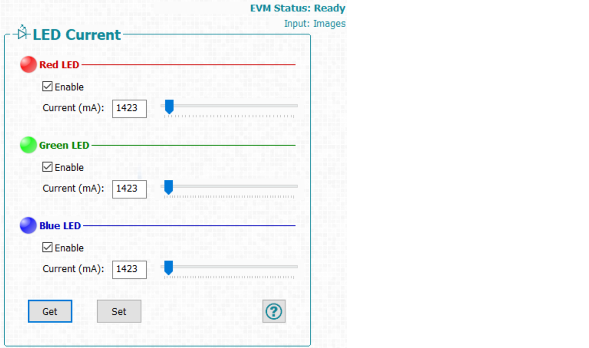

    I tried to change the LED currents down to the minimun (1423 mA). No change!
    The whole device consumes ~ 250 mA. I wonder whether the LEDs are enabled as shown on the GUI!

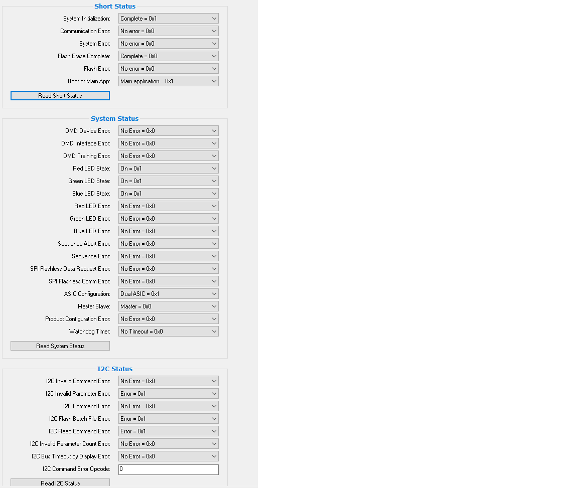

  • Hi User,
    Can you check the status in advanced mode of the GUI.
    Also can you probe the VBIAS, VRST and VOFS lines coming out of DLPA3005 PMIC. refer the schematic for signal (page 10) :
    Probe the signal very carefully.
    Navneet
  • Hi Navneet,
    Here is the status in advanced mode (s. attachment).
    The voltage level of the VBIAS, VRST and VOFS is very low. I am measuring 11 mV to 0 V!
    I can't explain the low voltage over there. According to the schematic => VOFS = 10V, VBIAS = 18V, VRST = -14V...

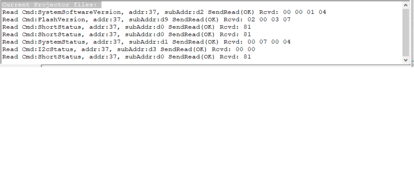

  • Hi Navneet,
    Thank you for the detailed reply.
    After installing the GUI, I was able to communicate to the EVM.
    The I2C connection was successfully established. I was not able to locate the "Write Pad Register Address" into the debug section. The only thing there is "Read Device Keyfusecheck".
    I couldn't find the "Write Pad Register Address" anywhere else.
    Please let me know if something went wrong over here.
    Lait

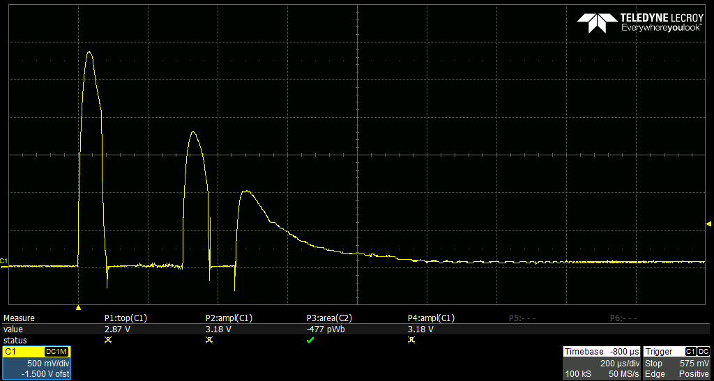

  • Hi Navneet,
    Yes. I found the problem. The 4710EVM has a high peak current at start-up which drives my power supply device into lock mode. It is not able to afford the start-up current.
    I am using now two channels of a digital supply device and it is working fine.
    The peak current on 0.1 Ohm resistor at start-up (SW28 to ON):
    And here is the current consumption after pushing switch SW21:
    Thank you very much for your support.
