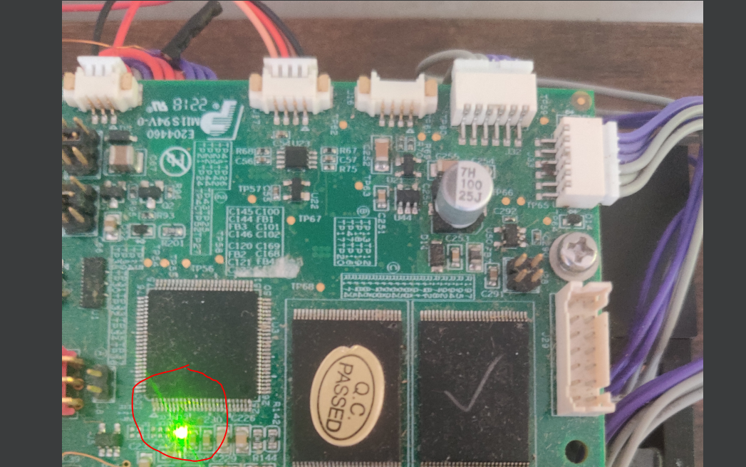

I am trying to run my DLP Lightcrafter 4500 in Video Mode, but it does not seem to be connecting successfully using the HDMI connector. The problem remains when connecting using several different PCs (all of them have no problem connecting via USB and communicating via the GUI). I have tried using PCs with both an HDMI output and a DVI-D output that go into the HDMI-mini connector on the 4500. The HDMI cable is working when plugged into a different device.

    Is there some LED to indicate the recognition of an HDMI connection? I saw this thread (https://e2e.ti.com/support/dlp/f/94/t/641502?tisearch=e2e-sitesearch&keymatch=DLPLCR4500EVM%2520d3) discussing a D3 LED, but I'm not sure where to locate it.

  • Hi Jon,
    Thanks for your patience. Kindly find the location of D3 marked in the below Image. This LED should come up when HDMI is connected to the EVM.
  • Thank you, Hirak. Our unit's D3 LED indeed remains off when the HDMI cable is connected (tried several cables now). I'm still in contact with Digi-Key, who will let me know how we can proceed with a replacement.
