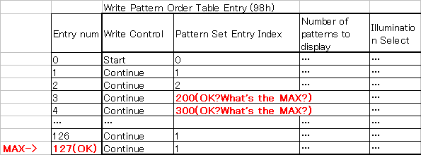

    The maximum number you want to know is about "Pattern Set Entry".
    Please refer to the example below.
    "Pattern Set Entry" is as long as the flash capacity
    Is there a problem with the maximum number?
    Tak
  • Hi Tak,
    I believe you are asking the maximum number of entries (i.e pattern sets) a pattern order table can have. If yes, then the maximum number is 128 and the system will through an error if you try to load more than 128 pattern sets in a pattern order table.
    Please let me know if you have any further queries.
    Mayank

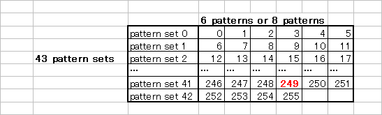

  • Mayank,
    Thank you for your response.
    The outline of the internal pattern is
    I understand it to some extent....
    And what you are telling
    I think it is the image shown below.
    My question is only the red letter pattern (249) in this table
    I don't know how to project it, so can you tell me?
    For example
    Using Write Pattern Order Table Entry (98h)
    Pattern Set Entry Index → ​​41
    Number of patterns to display → 4
    Even if you specify
    The result is projected as 246,247,248,249.
    This result is different from the purpose of
    I only want to project pattern 249.
    Please tell me how.
    Tak

  • Tak,
    If you want to display patterns of a pattern set individually then you can use "Write Internal Pattern Control". Please refer to the pause and step feature of this command for more info in the software programmers guide.
    Let me know if you have any more queries.
    Thanks and regards,
    Mayank

  • Tak,
    No problem in asking multiple queries, please keep on asking the queries until you are satisfied with the explanation. I will be happy to answer all of them.
    According to the proposal that I suggested, it is not possible to directly display jump to a specified pattern of a pattern set. and display it directly. Unfortunately, such capability is not supported by the system.
    If you want to directly display an individual pattern without displaying any other pattern then you can do it via the following way -
    1. Arrange the patterns which you want to display directly such as the 249th one at the start of there respective pattern sets. By this, you can jump on to that specific pattern using "Write Pattern Order Table Entry (98h)", ensure that you select the "Number of patterns to display" field as 1 so that only the first pattern in that pattern set is displayed. Also, set the repeat count parameter in WriteInternalPatternControl command as 0 so that it is displayed only 1 time.
    2. But if you want such capability for all the 256 patterns, then you will require 256 different pattern sets and this will not be possible as at max you can have only 128 patterns sets in a pattern order table.
    Let me know if you have any additional queries.
    Mayank

    It turned out to be a maximum of 256, which was helpful.
    However, this solution is effective only if it has a function to display 256 patterns,
    In fact, our system also requires the display of 256 patterns and other patterns.
    Initially, I was thinking of the following pattern set.
    Pattern set (0 to 255): 1 pattern
    Pattern set (256)…8 patterns
    Pattern set (257)…2 patterns
    Pattern set (258-267)... 1 pattern
    So my system needs a total of 268 patterns,
    If this number can be achieved, only by setting the pattern order table
    I can solve it.
    Is it possible to raise the maximum value of 256 patterns in the pattern set to 268?
    (It will also lead to cost reduction of hardware...)
    If you can't do this, you'll be using the other day's idea, "pause",
    It is necessary to deal with the mysterious behavior of the "pause" function.
    Could you please consider it?
