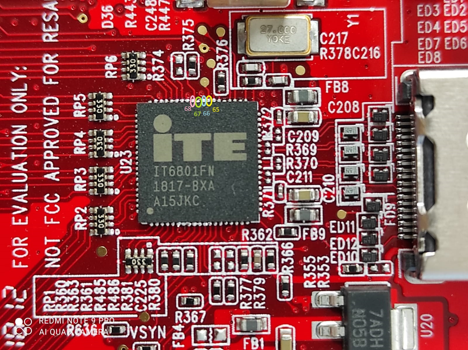

    We have checked the signals on the test points and we had the following responses (they were identical in the boot process and in the "steady state") :
    A) IT6801 component
    - test point 65: periodic signal from 0V to 3.3 V at around 3 MHz. The shape of the signal is a kind of "damped square".
    - test point 66: continuous 3.3V
    - test point 67: continuous 1V
    - test point 68: continuous 0V

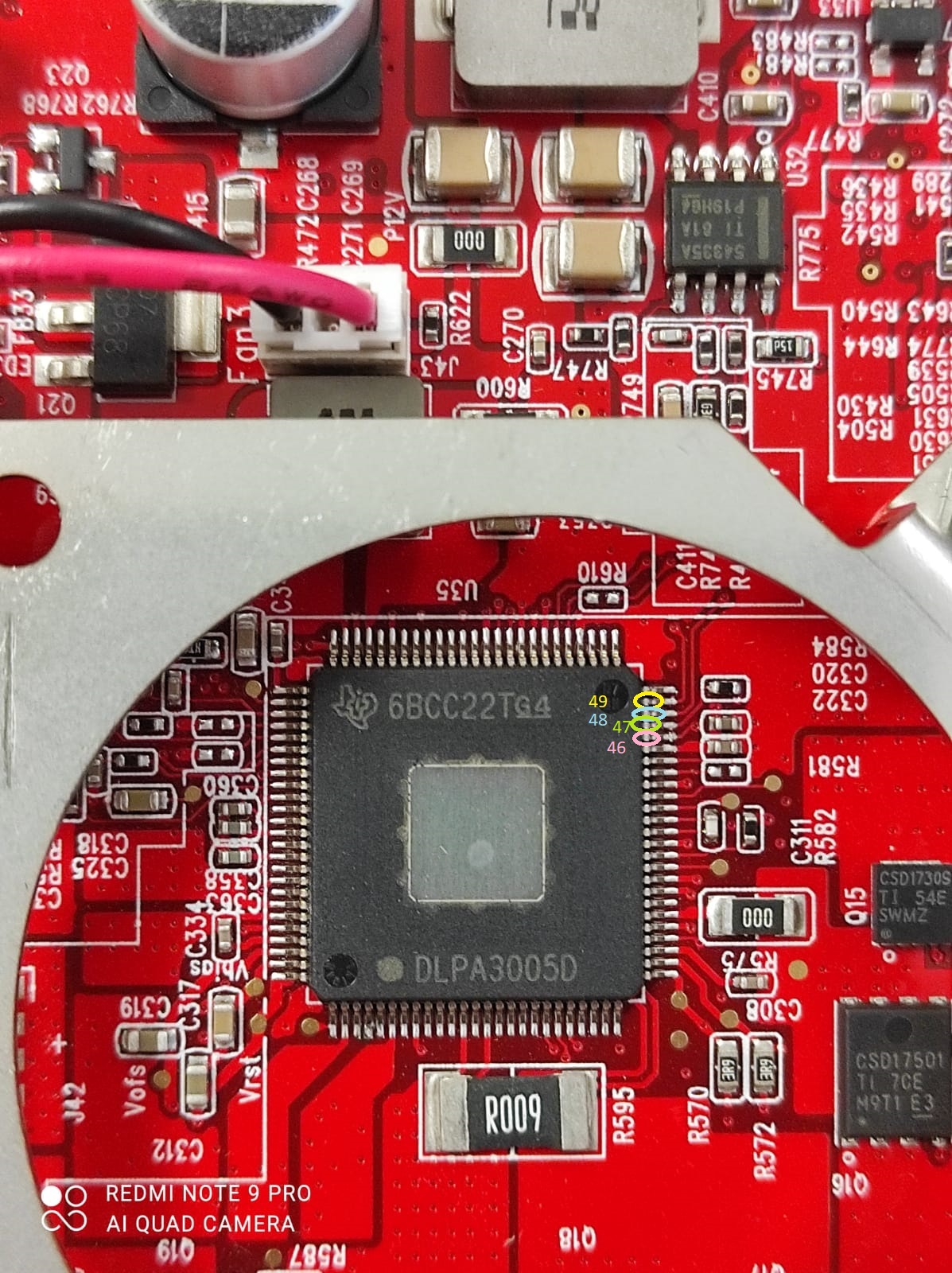

    B) DLPA3005 component
    - test point 46: continuous 0V
    - test point 47: continuous 0V
    - test point 48: continuous 0V
    - test point 49: continuous 0V
    Here is the photo of the IT6801 component showing the location of the test points:
    Here is the photo of the DLPA3005 component showing the location of the test points:
    It seems that the DLPA3005 is not working properly. I think that you should now consider to exchange my DLPDLCR4710EVM-G2 that should still be under warranty.

  • Bertrand,
    I understand. Apologies for any confusion on the same.
    The behavior you are reporting out implies that the system isn't getting into a boot state where it ever needs to communicate with the DLPA device. This is evidenced by your tests on pins 46-49. These SPI lines are used by the DLPC when communicating with the DLPA during bootup to initialize LED and power settings.  Since you are not seeing any activity then that means the DLPC is never executing the boot sequence where it would configure the DLPA in the first place.
    Since the boot sequence is not occurring and attempting to reprogram the EEPROM results in a verification failure, the most likely possibilities are as follows:
    > The DLPC or the EEPROM device (U18) holding the DLPC object code/image are somehow damaged or faulty such that it is inoperable
    > The board is damaged such that critical communication lanes (SPI communication with the EEPROM, or SPI communication with the DLPA) are cut in some manner
    In either case, there is sufficient cause that I would recommend you contact the TI.com support page mentioned above to ask for a replacement unit.
    I hope this helps. Let me know if you have any additional questions
