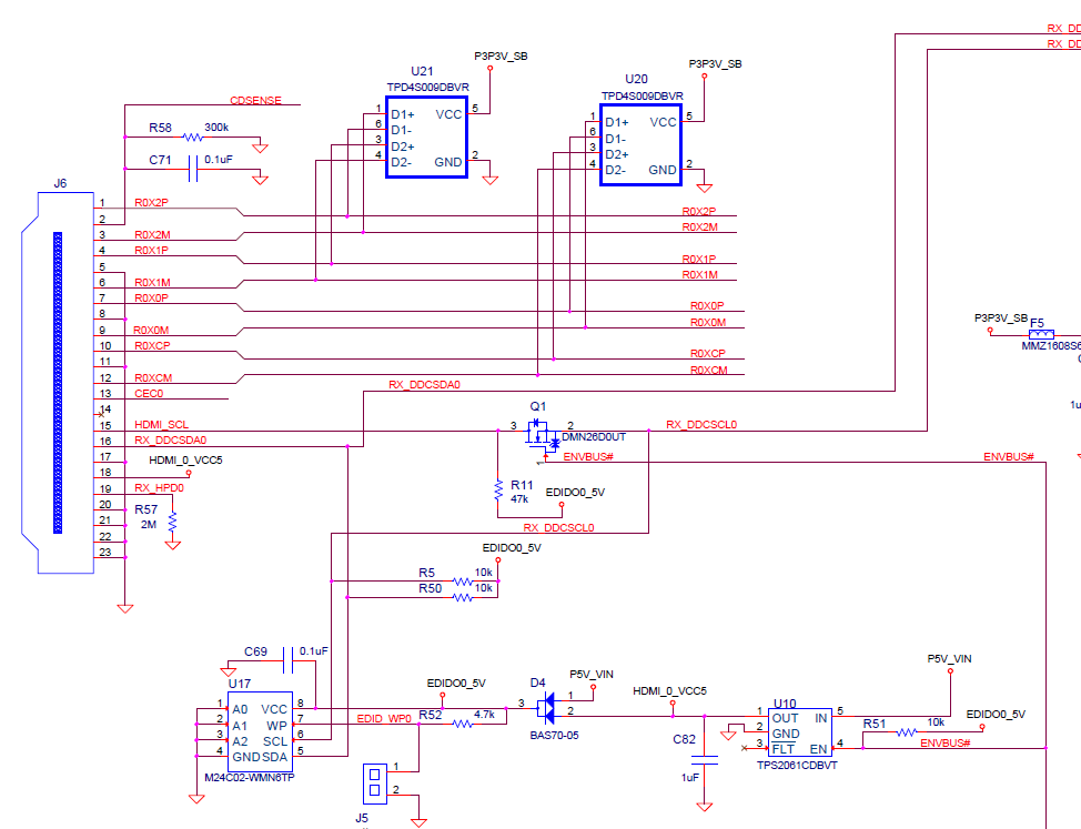

    To reiterate the requirements from a previous post, we need the EVM to tell what resolution and fps it needs from the host, not the other way around. We are not using a Windows PC as the host. We need the EVM EDID to specify 854x480 @ 104 fps.
    Navneet explained that a Devasys board ( http://www.devasys.com/usbi2cio.htm ) and Adapter board "for connecting the Devasys board to HDMI" will be needed, as well as "8 pin clip to program the EEPROM - which will also help you to remove write protected (pin 7 )", "we are shorting the pin 4 and 7" and that we will receive a new binary for the EEPROM with the settings we need.
    So right now we need a link to the "Adapter board" to know which one is needed exactly and the binary file to reflash the EEPROM.
    Thank you.
  • Hello John,
    Allow me to clarify a few things about the EDID. The EDID (Extended Display Identification Data) is simply as standard data format that is stored in the EEPROM which will tell a video source (such as a PC over HDMI in your case) what video data is accepted. Therefore, you can use any standard EDID editor to create a custom EDID file. It can then be programmed to the M24C02-WMN6TP EEPROM device on our board using any tool supported to reprogram an EEPROM. I believe Navneet was looking into what tools we have used in the past at TI; however, there shouldn't be anything specific from our side on what's needed. The relevant circuit info can be found here and a screenshot is below.
    For us the Devasys is used to convert USB of the PC to I2C. The adapter then sends the I2C signals over the HDMI connector to the EEPROM (U17) to reprogram it. It will likely depend on your tool setup how this is done. Other times clips can be used to directly connect to the EEPROM and program it as well. I hope this info helps.
