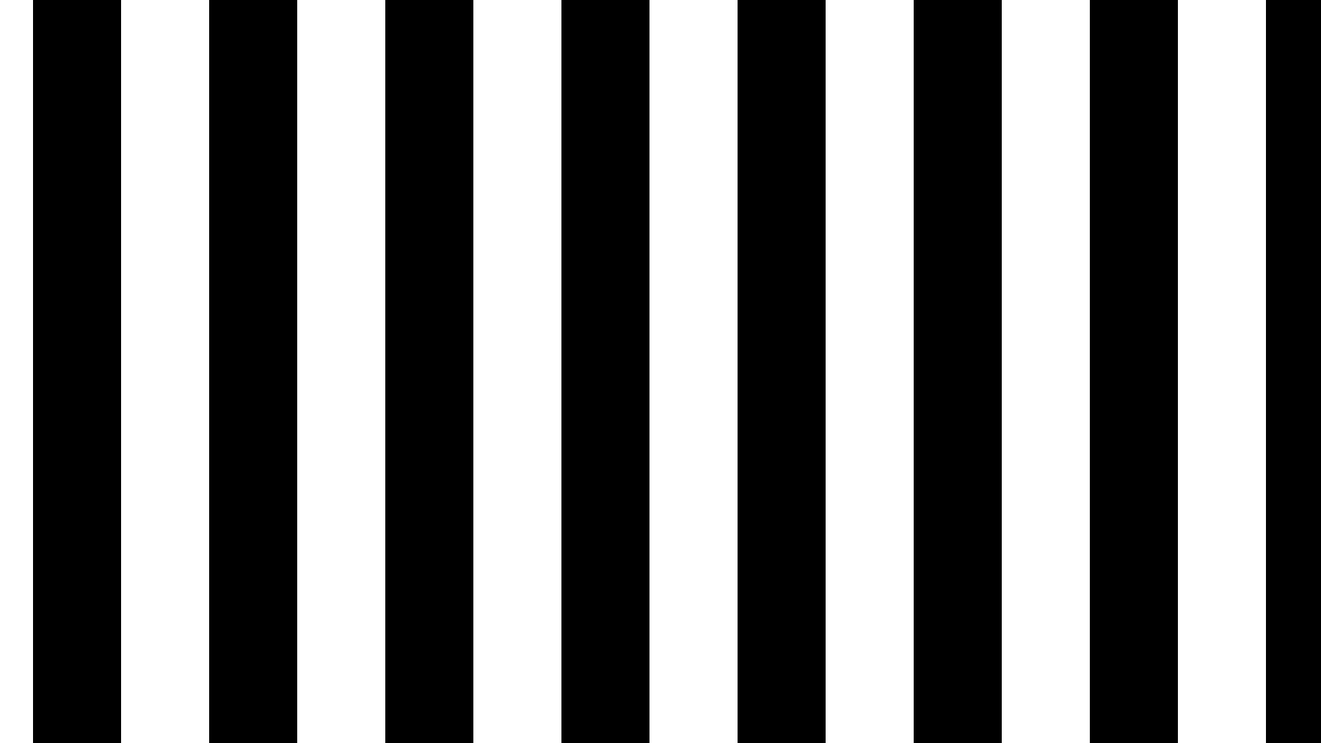

The module is mixing patterns almost everytime. The screen is split into right and left halves, every side displays different patterns and in different order than the other one. It looks like this:
The module is operated via DLP C API. Both sample project and our project with linked dlpc api provide very similar results. I have tested couple of different configurations, the resulting display order for both sides is described in table:

Patterns are generated correctly - the image data generation was tested separately. The screen halves are not corrupted, mixed or deformed - it's a strong proof that the pattern data is correct.
Please fix this issue by providing patched firmware and/or fixed dlpc_api (whetever is the source of this issue).

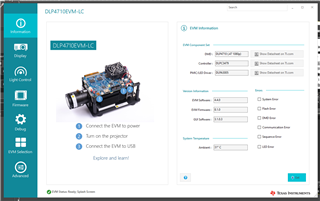

    I tried to reproduce the issue using DLPDLC-GUI ( https://www.ti.com/tool/DLPDLC-GUI )
    And I am able to display patterns correctly using the GUI. Can you please share the exact pattern configuration details (pattern sets, pattern set order etc) so that it enables me to see if I can reproduce the issue using GUI.

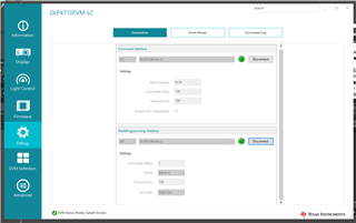

    1) Concerning the latest GUI:
    There is an error (Get Video Information Error) every time I try to connect and get information from the EVM:
    But when I switch to the "Debug" tab:
    I can connect to I2C and SPI without problems:
    And when I get back to the "Information" tab, the error is gone and info loads properly to the GUI:
    The previous GUI version was able to connect and load info in the first place.
