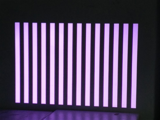

I am using the DLP LightCrafter 4500 in pattern sequence mode. I am confused that the images added to the firmware are all 912*1140 but they are displayed with the resolution of 1140*912(seems to be). Visually, they are zoomed  both vertically and horizontally. I wonder why this happens. Thanks.

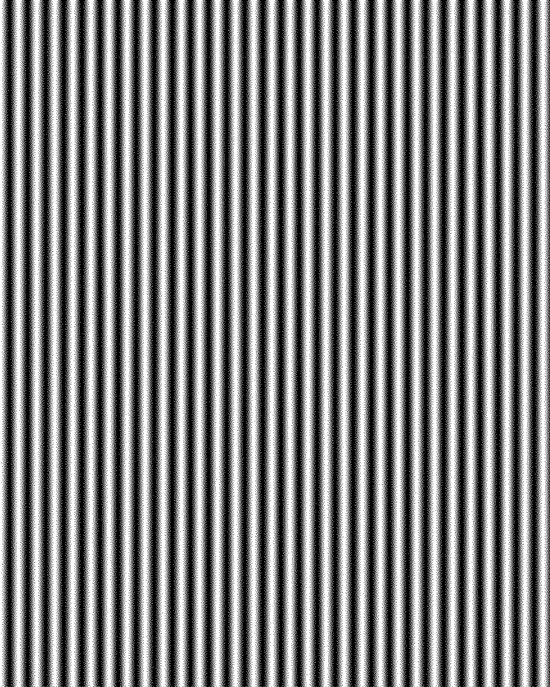

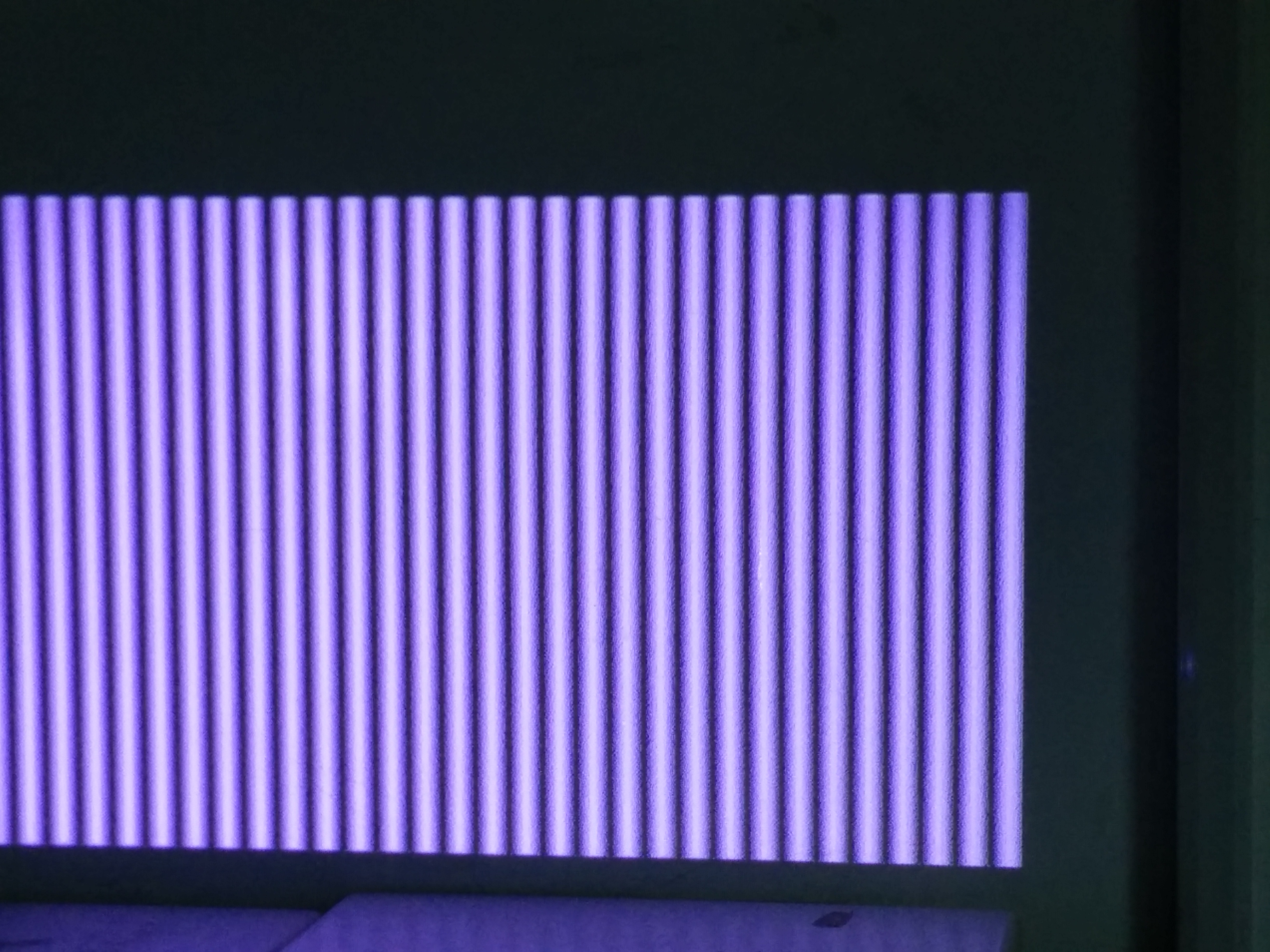

  • Hello Sanjeev
    Usually I put 16 1-bit images(912*1140) into one 24-bit color image using "create images" tab, then add this 24-bit image to firmware and upload the firmware. BTW, I didn't adjust anything in the INI file.
    Original images are as follows:
    however the displayed patterns are as follows:
    It seems that they are inverted or changed.
  • Hi Jiangzhao Lv,
    Oh Ok. I understand your point now.
    When you see a 912x1140 image on PC it naturally looks bigger in height compare to the width.
    Now in the DLP4500 chipset, look at the DMD specification http://www.ti.com/lit/ds/symlink/dlp4500.pdf Figure #3 details about the DIAMOND PIXEL orientation and arrangement and how the pixels are packed. Then look at the Figure #15 about the physical dimensions (shown in Table 5. Micromirror Array Physical Characteristics) the
    physical spec says
    width = 9855um (912 pixels)
    height = 6161.4um (1140 pixel)
    So this results in showing the image of 912x1140 dimension looking bigger width wise compared to the height in contrast to more pixels in height wise.
    Feel free to revert back if anything not clear.
    Sanjeev
