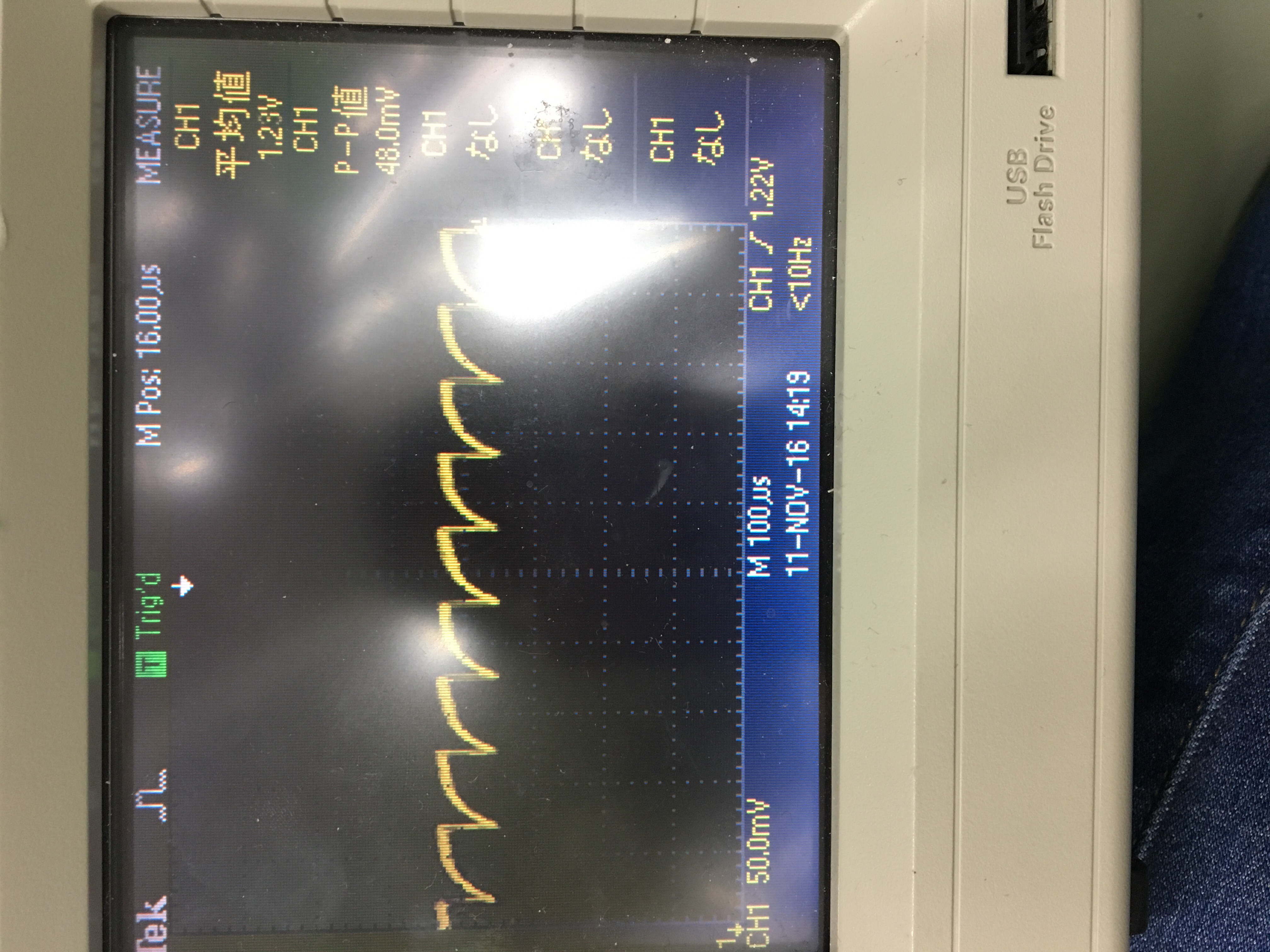

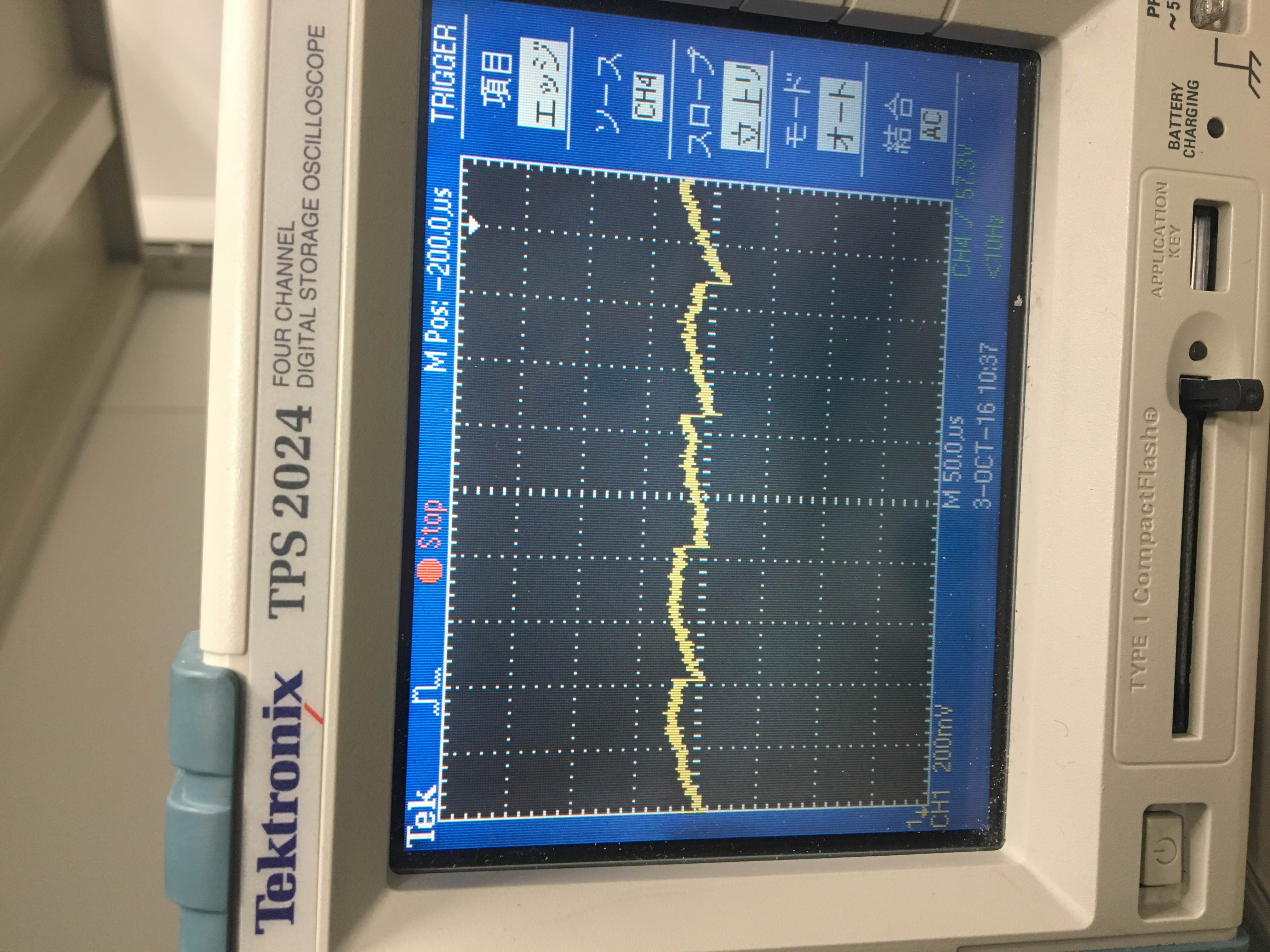

    I see. I first heard from my friend who is using the same evaluation module (DLP 6500EVM) that it has a 105us 'blinking'. I also saw that by monitoring the light from the DMD using a photo diode (picture attached). It looks light the mirrors are slightly vibrating at around 10kHz which is not good for my application.
    Thanks!!
    Eunmi
  • Hi Eunmi,
    I'm not sure what would be causing the behavior that you're seeing. The mirrors on this device can only be driven up to ~9000Hz by the controller, so those vibrations are too fast. It is interesting that your friend is seeing the same behavior.
    Can you describe to me what pattern you are displaying to the photo diode?
    Paul

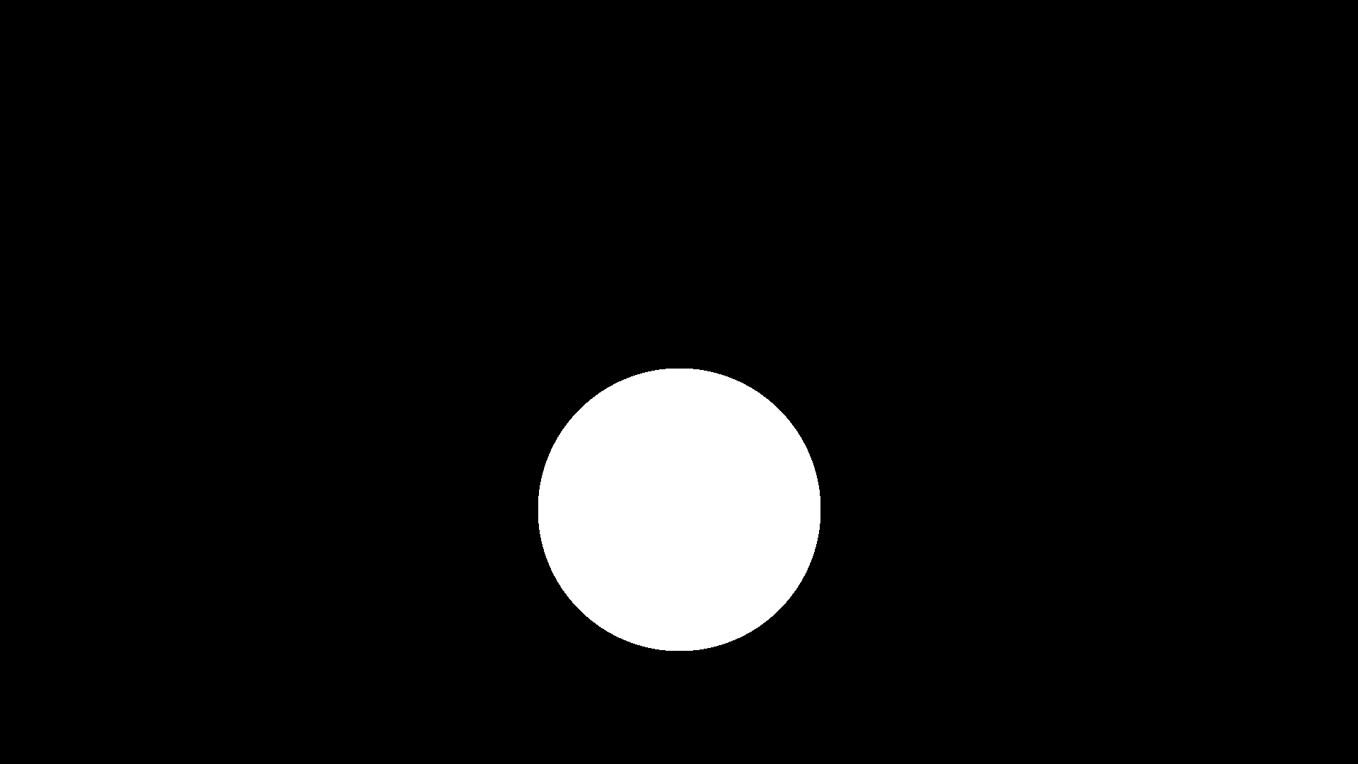

    I was displaying just a circle on the DMD, with 'pattern on the fly' mode, exposure time of 0.5s, no turn-off time, in repeat.

    I'm using a python code to communicate with the DMD. The image is binary, and is a circle at the center of the DMD with the radius of 100 pixels which is also generated in the code.
    The setting is exposure time of 0.5 s and no dark time. This single pattern was repeated.

  • Hi Paul,
    I don't think my friend uses the same light source. I also checked with a different light source and still observed the same behavior.

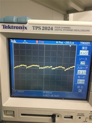

    The intensity signal from the DMD was about 1.2V on a photodiode and the ~ 10kHz intensity fluctuation was about 50 mV, which means about 4 % of the light intensity is fluctuating.
    thanks,
    Eunmi

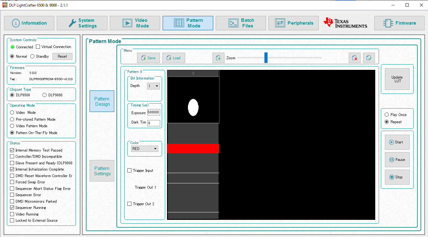

  • Eunmi,
    Please assist me by posting a screenshot of your GUI with the pattern you are displaying as well as the image you are uploading to the device.
    Thank you,
    Paul
  • Hi Paul,
    Below are the screenshot and the figure for the DMD.

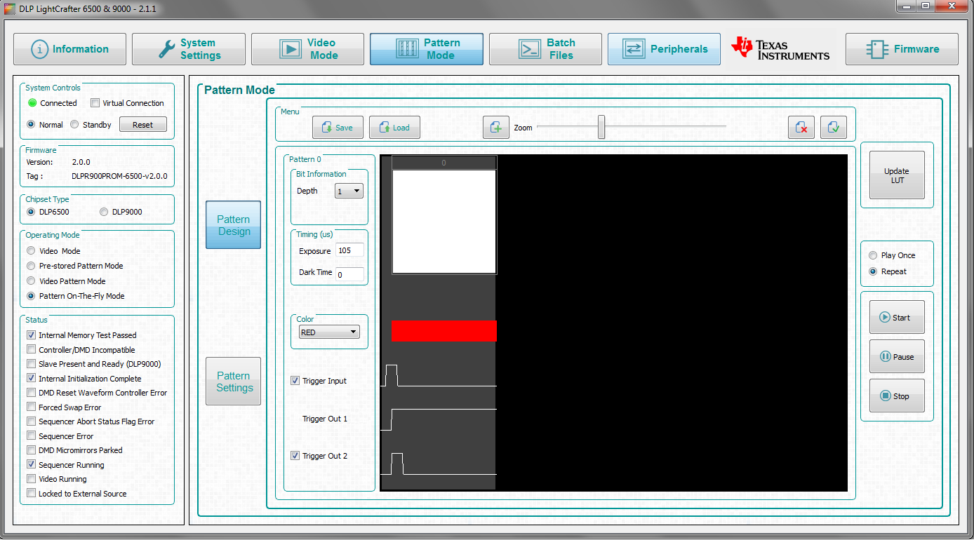

    I'm in the same situation; I would really like to disable the 10 kHz mirror reset signals.
    I tried to set the exposure time to 105µs and the Dark Time to 0 in the GUI, as shown below.

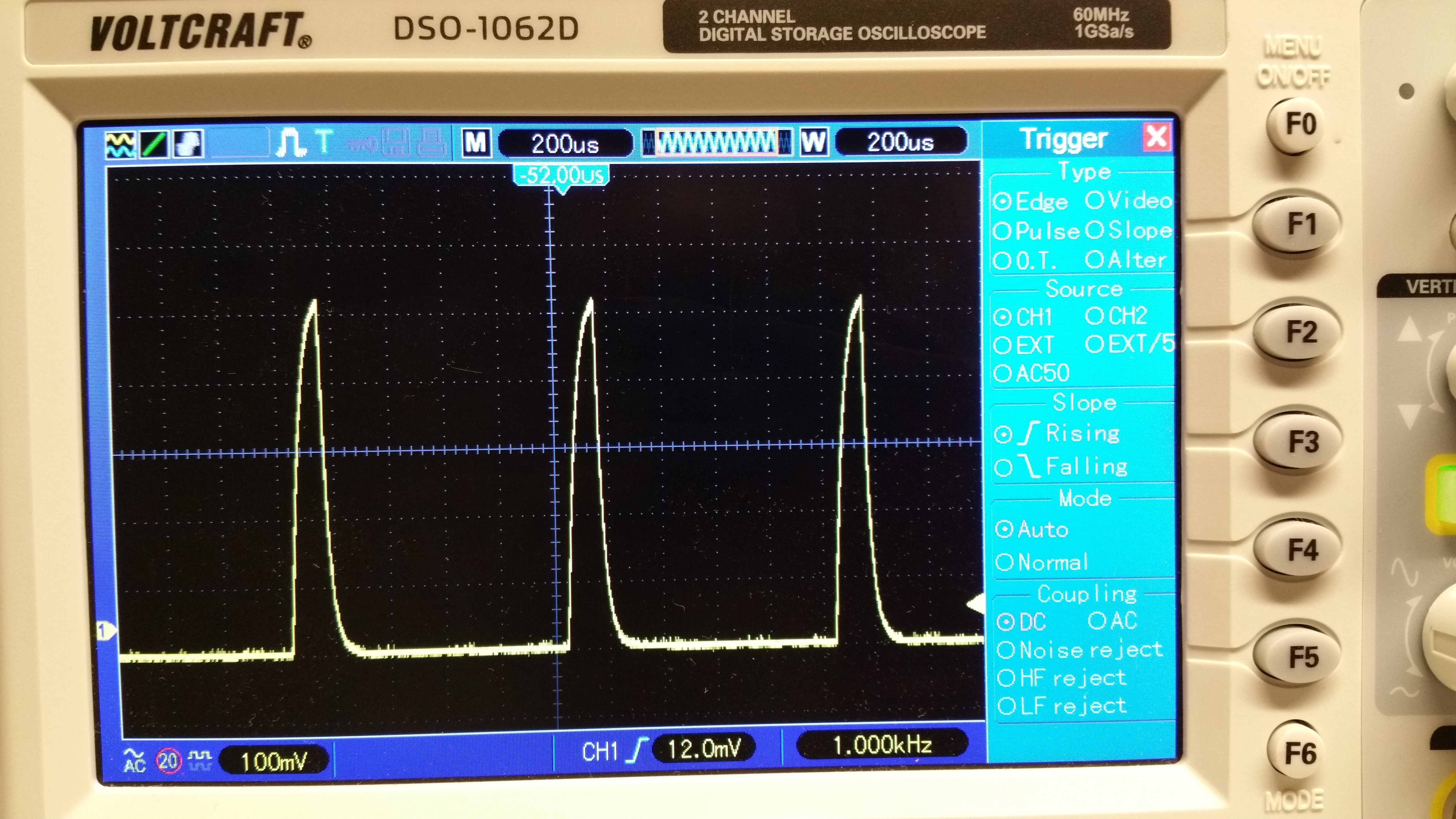

    I then hooked the DMD up to a frequency generator that produced a 1kHz signal, which would correspond to a period of 1ms. If I understand your previous reply correctly, I would expect 1ms exposure on the DMD and no 10kHz mirror reset signals.
    Looking at a by the DMD reflected laser beam, this is unfortunately not the case. I don't see any 10kHz signal but instead of seeing a 1ms exposure, I see a 105µs exposure every 1ms. This is shown below:
    For my experiment this outcome is unfortunately even worse than having the 10kHz mirror reset clock signal.
    Have I understood your previous solution correctly and/or do you have a workaround so that can show a truly static image on the DMD for more than 105µs?
    Nicolai

  • Hi Nicolai,
    I confirmed that what you are seeing is correct. Unfortunately, after consulting further with the experts, the fix that I suggested above is incorrect and will not work.
    It is built into the FW of the DLPC900 to have the 105us reset pulses and there is no other work around short of modifying the board or the FW. Please accept my apologies on this.
    -Paul
