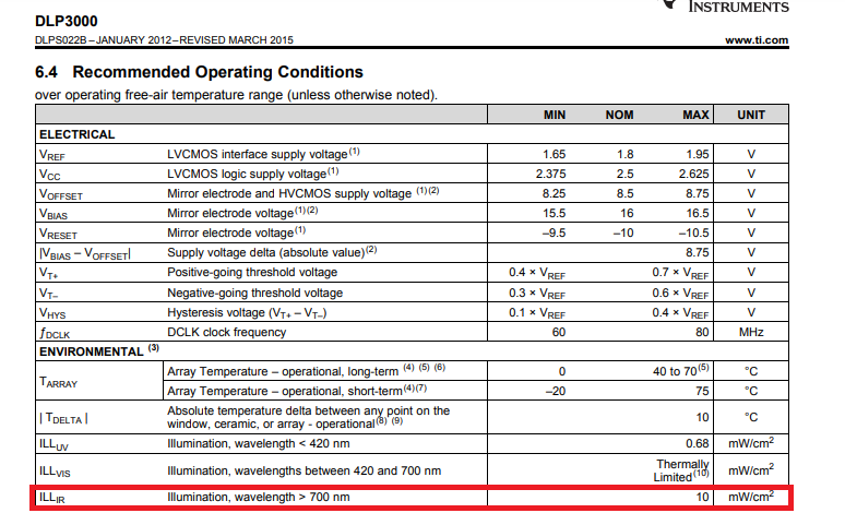

An experiment that uses DMD (DLP3000) with flash pumped Nd:YAG laser with an output power of 2.3mW and wavelenght of 1040nm resulted in a damaged DMD when all mirrors were set to the off-state.
Recommended operating conditions gives maximum illumination for wavelengths of greater than 700 nm is given as 10mW/cm^2. Clarity is required regarding these thresholds.
There are additional experiments planned but to avoid future damage it would be good to understand the root cause of the damage that has occurred in this case.
Note that the system was working fine before all the mirrors were set off so it is assumed that this is the root cause of the problem.

  • Dear Vivek Thakur
    A colleague and I from the Structured light Laboratory, University of the Witwatersrand, South Africa have been in contact with David, and the power generated by the laser is 2.3mW.
    According to Section 6.4 of DLP3000 DLP 0.3 WVGA Series 220 DMD datasheet (Rev. B) (please see the link), there is a stated Recommended operating illuminating condition of 10mW/cm^2 for wavelengths greater than 700 nm, which implies that the device should be able to operate at these wavelengths. As we are well below the illumination threshold, we do not understand how the device has sustained damage.

    Vivek> DLP3000 is designed for the visible light wavelength 420nm- 700nm. A typical wide spectrum light source also generates some amount of UV and NIR light. The MAX number if table 6.4 of the datasheet is referring to maximum exposure level for such wavelength when operating in the 420-700 wavelength range.
    It is likely that device might have damaged due to electrical issues like ESD, noise in the signal etc. You may also damage the device with laser if the laser beam is concentrated /point source, resulting in a very intensity at small location even though total power may be low or/and you pulse at a very high intensity for short duration.

  • Dear Vivek Thakur
    Thank you for response, and my sincere apologies for the delayed reply.
    We are still unclear about the following:
    • There is a recommended operating condition which specifically states a maximum illumination threshold of 10mW/cm^2 for wavelengths greater than 700 nm (please see image below). I have made a red box of the stipulated recommended operating condition.
    • It is clearly stated that there is such a recommending operating condition. As we are well below this illumination threshold, even during short pulses, we are still not clear on how the device sustained damage. We are unsure of the type of electrical problems that may have caused damage, may you please be more specific on this matter?
    • Figure 1 page 2 of www.ti.com/.../dlpa031c.pdf refers to devices with Corning 7056 window transmission curves. The DLP3000 has the Corning XG window, which has transmittance of more than 80% for the visible and NIR coatings.
    Thank you for your assistance with regards to the other issues mentioned.
    Ravin Kara
  • Hi Ravin,
    It is very likely damages may be due to some factors likely electrical, not optical.
