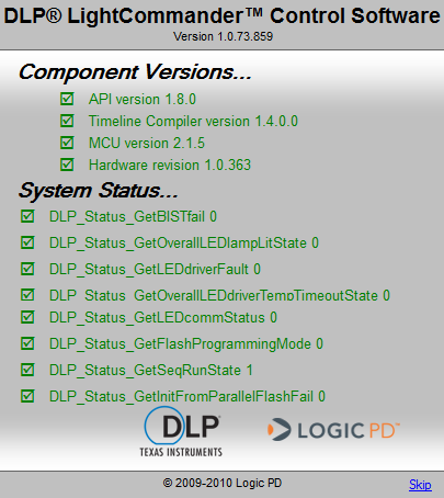

Recently we disassembled the LightCommander (LC) to be able to use the LED-module and the DMD-module separately. Everything worked fine. After reassembling however the LC will not project anything. The problem seems to be that the LED's are not turning on, except for a small flash when flipping the master on-off-switch to the on-position. When the LC is connected to a pc and the SW is Logic SW is started, the startup screen shows all green but the OverallLEDlampLitState returns zero (see screenshot)

    GetLEDDriverFault 0 indicates the main controller board is able to talk to LED Driver.
    GetOverallLEDlampLitState 0 LEDs not LIT.

  • Dear Sanjeev and Fizix,
    I took the DMD out of the DMD-board and put it back in again and then the checkerboard was visible. After that I reassembled the whole LC and it is working again!
