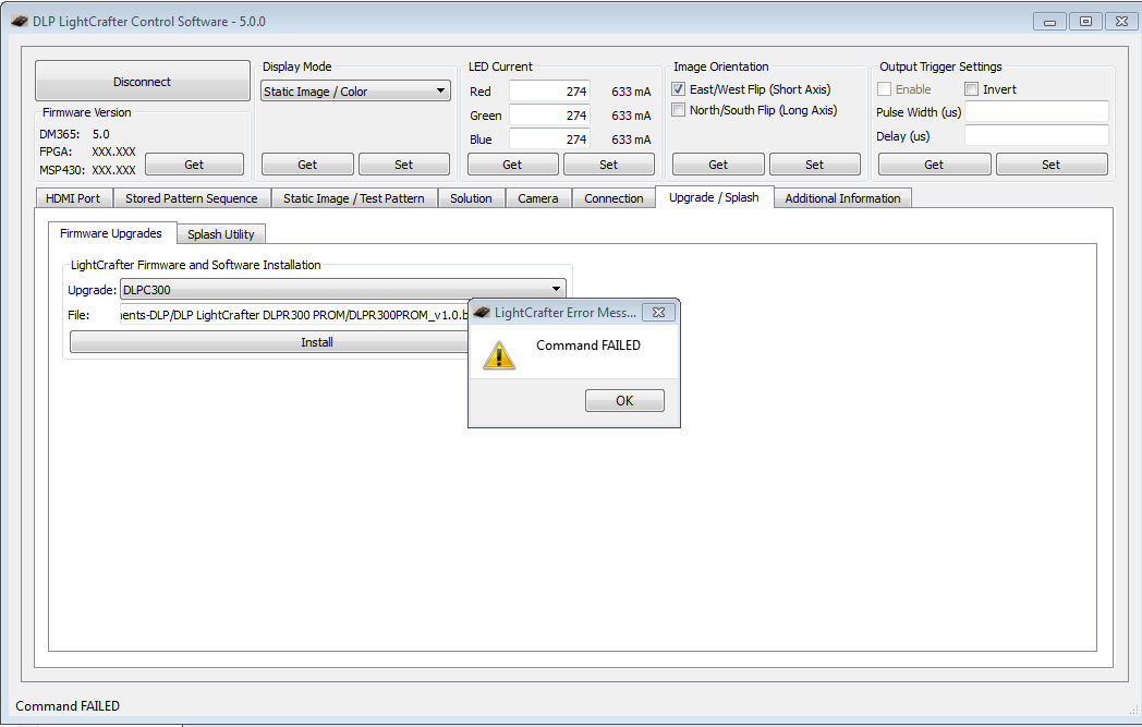

  • Thank for your reply。
    I have removed the light engine. I think it is OK to connect the DLP by GUI. But it has a problem as the figure.
    But I can not upgrade the DLP300.
    I think I use the correct its for DLP 300 as the figure.
    But it failed.
  • Hi Manasi,
    The current problem is that I can  not upgrade DLPC300. So the state of DLP  can not be changed.  I have show the situation in picture. What can I do now?
         Ziyi
  • Hello Ziyi,
    This usually is a problem of DLPC300 firmware being corrupted.
    Could you try upgrading the FPGA and MSP430 firmwares first, hard reboot the system and then try upgrading the DLPC300 firmware?

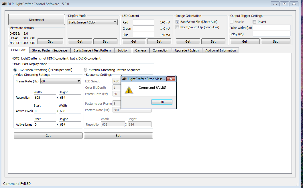

  • Hi Manasi,
        I have tried to upgrade DM365.v5.0  by SD card. After that I still can not upgrade the MSP430 and DLPC300. I don't know whether I upgrade DM365 successfully.  We have remove the light engine so that I can not see the upgrading image from DLP. I just can observed the light from red to green in the upgrading process as the figure. I feel it did n't success.
  • Hello Ziyi,
    I see that in the second picture, the LED D1 turns Green. That means it has been successfully upgraded the DM365 firmware. In this case, were you able to connect to GUI and do a "Get Version".
    What are the DM365, MSP430 and FPGA versions that you get?
    Did you then try upgrading the DLPC300 firmware?
    Manasi

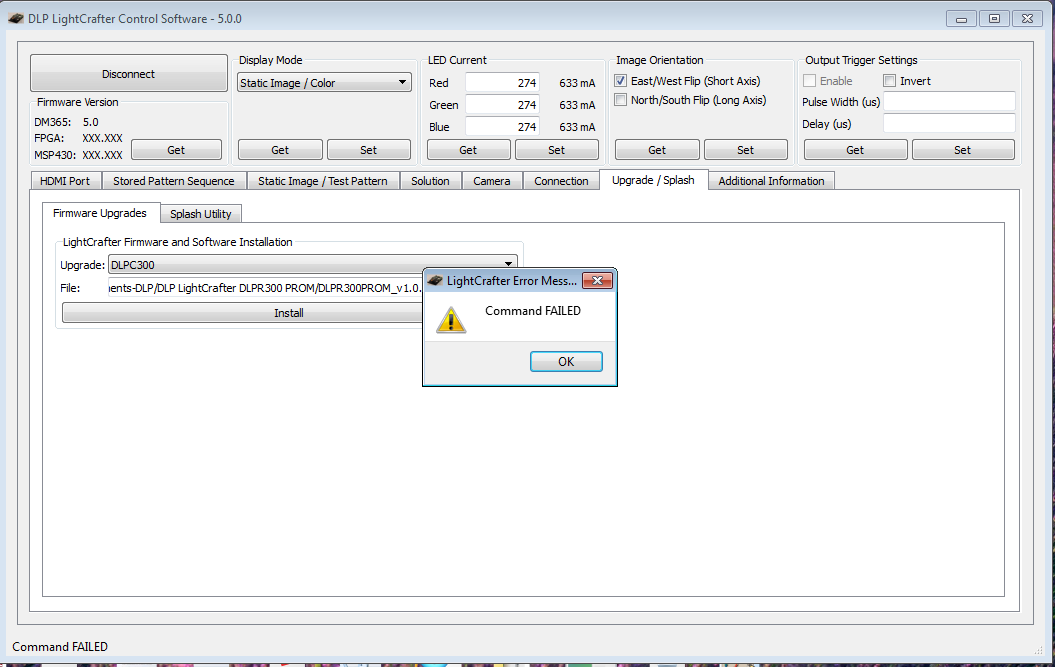

  • Hello Ziyi,
    From this information, I am pretty sure it is DLPC300 fimware corruption issue. Can you now try and upgrade the DLPC300 firmware, now that you can connect to GUI.
    Manasi

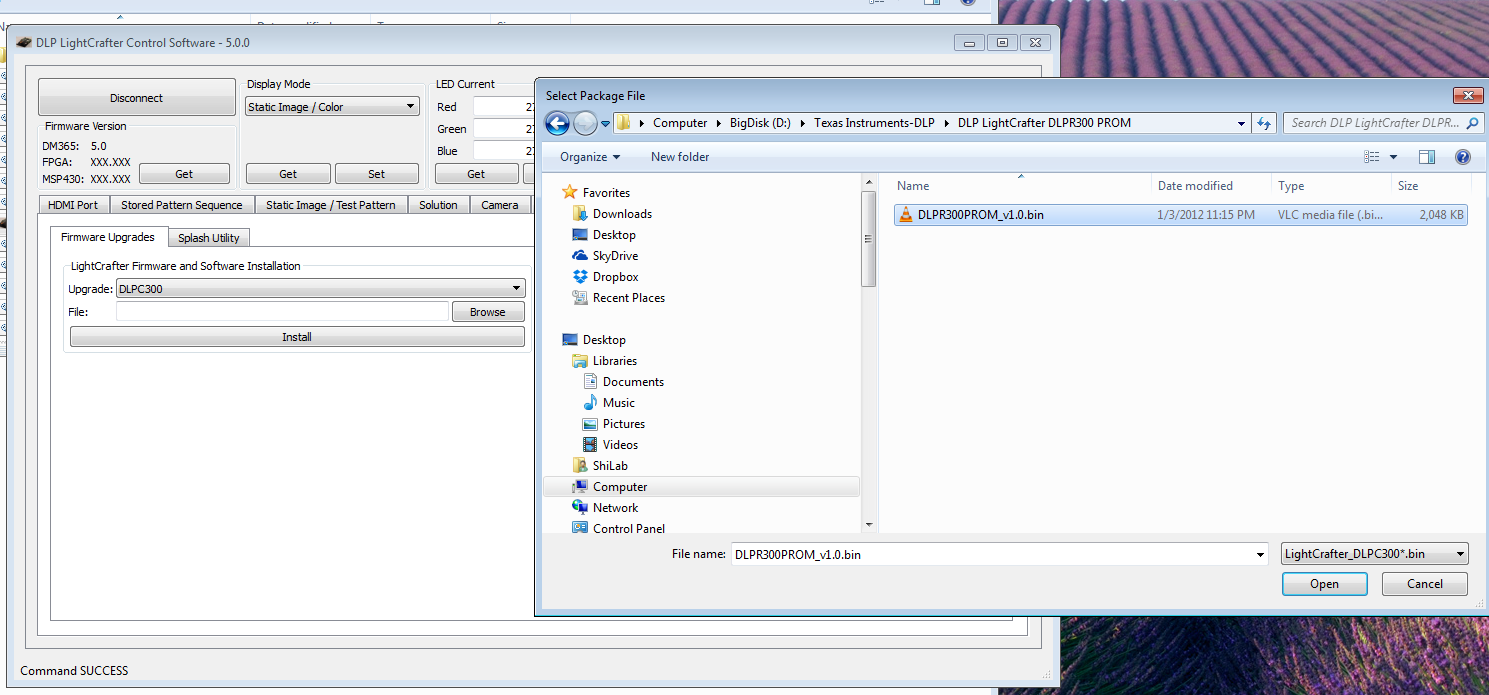

  • Hi Manasi,
        The big problem is that I can not upgrade DLPC300, it tell me failed when I upgrade DLPC300. I think if I can upgrade DLPC300 successfully, the problem will be fixed, but I can not , as the figure.
    The DLPC300:
    After processing, it shown
        Ziyi
