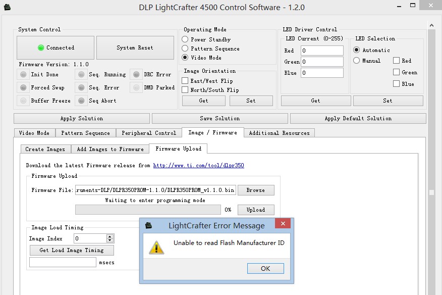

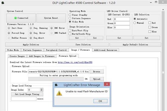

Hello everyone: when I want to write firmware to DLP LC4500, it not work with the exception:Unable to read Flash Manufacture ID. how can i do ?
  • Hello Lei,
    Can you provide the detailed steps to reproduce? Like what other operations you performed before attempting the FirmwareUpload.
    Once you see this message, are you able to perform other activities? Does it responds to other commands? If you power off and power-on. Does it work properly?
    Sanjeev
  • Hi  Sanjeev,
    Thank you for your replay. I performed this operation in windows 8, it didn't work like i said above. But when i do the same operation in windows 7,it works!  I don't know why. Meanwhile , when I try to config the DLPC350 through I2C , I use the STM32F407 in master mode .but i can't work well. I can read the register but can't write it .And no any exception  occurred. Do you know why?
  • Hello Lei,
    On Windows 8 did verify whether the driver recongnizes the device when connected via USB.
    About the I2C looks strange to me If read since you are able to read the registers from DLPC350 i don't see any reason why it shouldn't work. One suggestion look at the http://www.ti.com/lit/pdf/dlpu010 section 1.1.3 I2C Write Transaction Sequence and see if you are missing any step.
    Sanjeev
