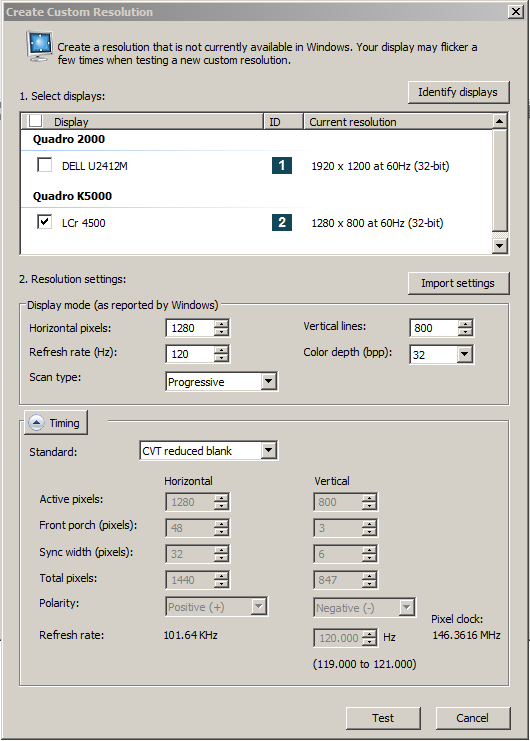

    I too like Jonathan have a Lightcrafter 4500 and am unable to drive it at 120Hz. The projector is connected to an Nvidia Quadro K5000 graphic card which is capable of achieving that refresh rate. When I try to manually set a custom resolution/refresh rate in nvidia's settings, I am presented with the following screen. You mentioned that the timing values are in the linked document, but we seem to be unable to decipher the right values. Could you please let us know what numbers are we to enter in the timing section to get the refresh rate up to 120Hz.
    Hopefully, once we have this set up we can attempt to increase the rate with pattern mode settings in the lightcrafter gui.

  • Hello Dhruv,
    Couple of questions to you -
    1. I believe without any custom adjustments, with this graphics card, the LightCrafter4500 kit is able to lock the signal perfectly at 1280x800@60Hz. Is this correct?
    2. Now you are attempting with custom resolutions, 1280x800 @120Hz, you settings look OK to me. When you click on the Test button, isn't  the DLP4500 Kit locking to the video signal? Let me know what you are seeing.

  • Hi Sanjeev,
    You are correct, the LC works great at 1280x800 at 60Hz.
    When we attempt to set the refresh rate to 120Hz (with CVT reduced blank), the test is successful and the windows desktop appears. The problem however seems to be with the refresh rate, mouse movement is choppy and skips frames, video playback is not smooth. It appears as if the refresh rate has dropped below 60Hz.

  • Hello Dhruv,
    I tried the same thing here, for 1280x800@120Hz, the DLPC350 is actually reusing the display sequence which is defined for 60Hz with some additional compensation adjustments. That is why you are seeing such visible artifacts.
    Although LightCrafter 4500 Kit is capable of locking to sources from 10Hz to 120Hz you may not get best viewing experience for some frequencies due to the reasons as explained above.
    We want to reiterate the purpose of DLP LightCrafterKit 4500 as a evaluation platform for using DLP4500 DMD device for non-display applications like machine-vision, 3D scanning, etc... where the 1:1 grayscale value reproduction is important. The kit may not give the best performance like the commercial DLP Projectors that are having optimized display sequences for 120Hz.
