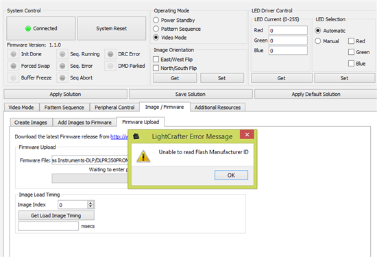

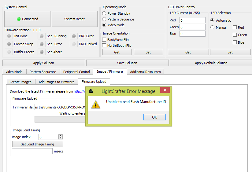

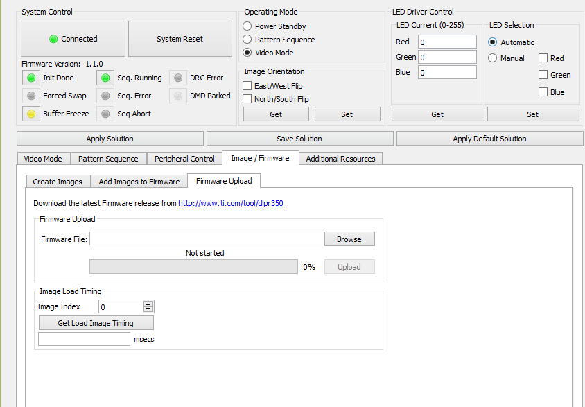

  • If this information helps clarify anything, here is the screen before I try to upload firmware:
    and here is the screen after I try to upload it.
    I can do other things like Get Image Load Time with no problem.  The binary firmware file is valid and there doesn't seem to be any driver issue (the manual itself said the device doesn't need a driver).

    I am getting the error again.  The first time I plugged it in after I came back this weekend, I could not enter programming mode.  The symptoms are exactly the same as before - it works, I go away for some time, and somehow it gives me this error again.  I tried fixing it the same way as last time, but that didn't work. I am just trying things now and hoping something works...
    In case it helps, sometimes I see the indicators for forced swap and seq abort turned red, other times they are all gray.  Usually, the 'connected' indicator is green, but sometimes its red.  Each time I try to enter programming mode, the USB driver makes the 'disconnected' sound.  Most of the time, it never makes the 'reconnected' sound, but sometimes it does.

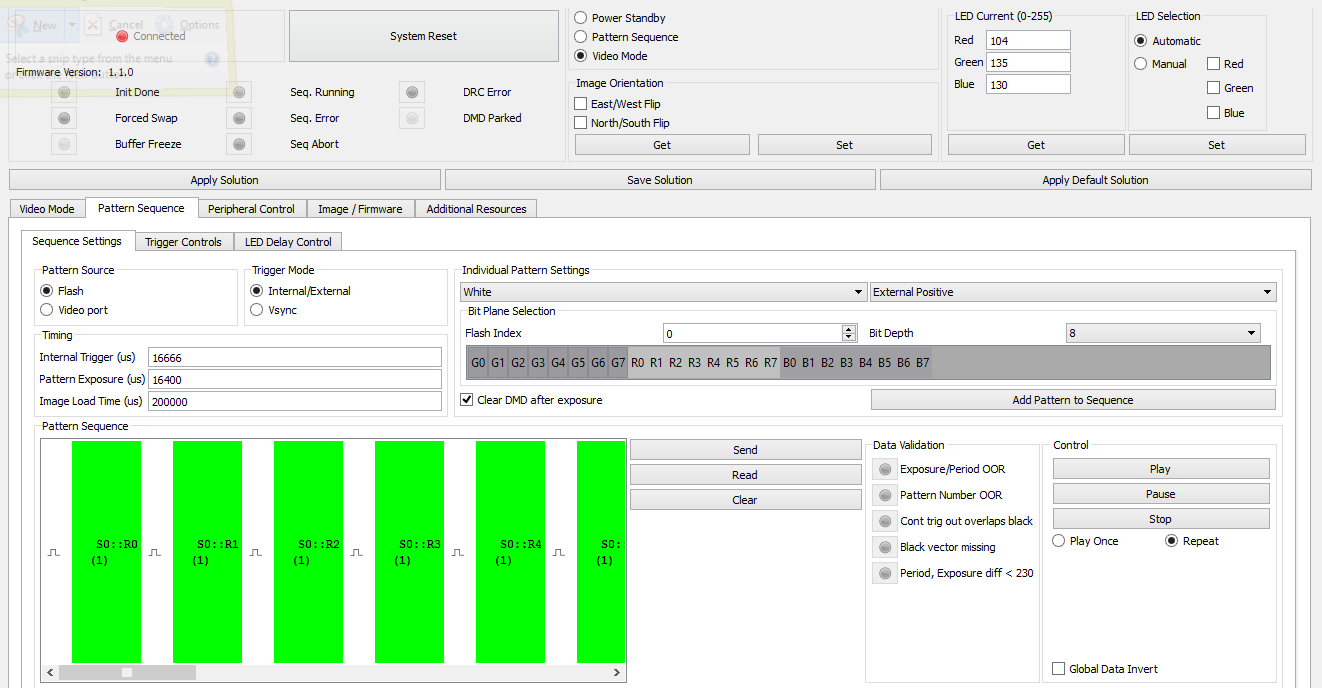

    I am running the default solution that was given straight out of the factory (shown below):
    Under normal (i.e. working properly) conditions, I thought the USB disconnects as soon as the firmware starts uploading and reconnects when the uploading is finished, but I can't remember for certain.  I did try running it on another PC and the problem originally persisted, however I applied the default solution, reset the board, and the problem went away.  I then moved to my original PC after the weekend and the problem was there again - I will check with the working computer again asap...
