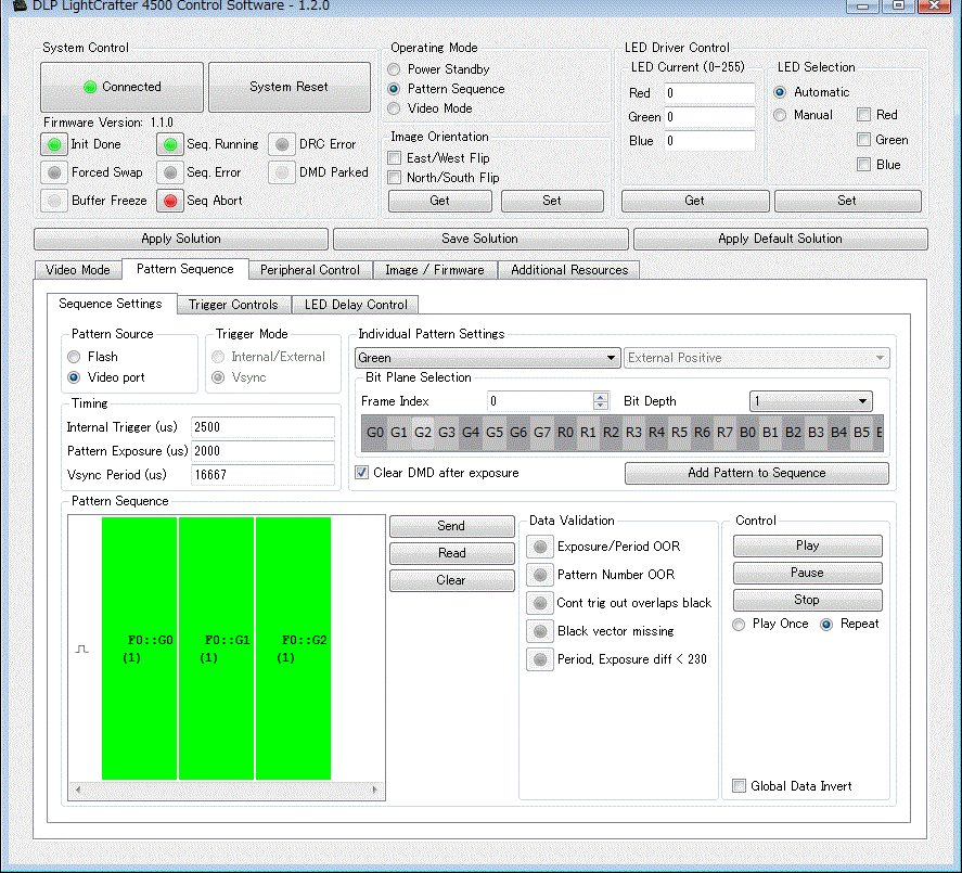

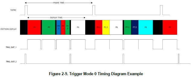

In Trigger mode0, DLPC350 PG describes that VSYNC starts pattern sequence consists of multi patterns.

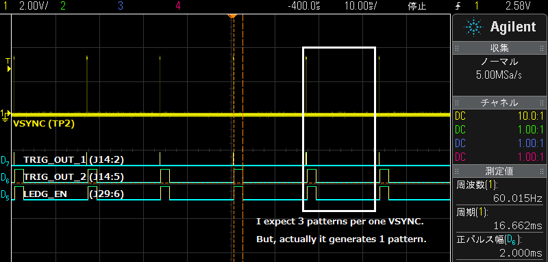

But, my measurement is different. It displays 1 pattern in each VSYNC.
I attach my GUI configuration.
Question)
How can I make the timing like Fig 2-9? (dlpu010d: P40)
Best regards, RY
Expected timing (dlpu010d: Fig 2-9)
My measured timing
My GUI configuration

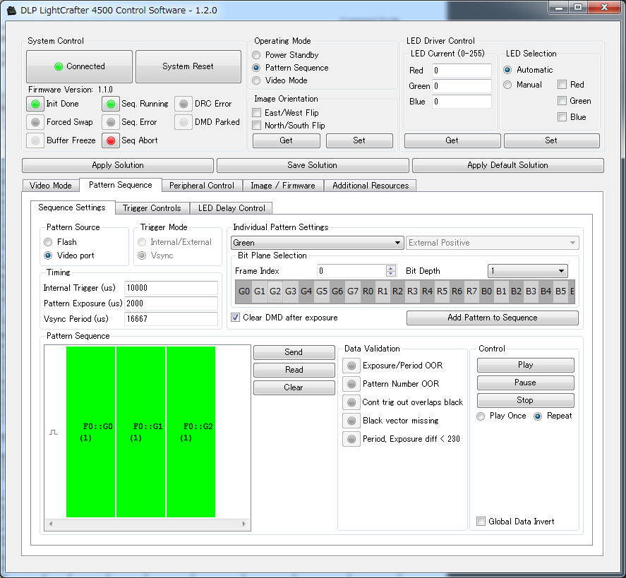

  • Hello RY,
    The problem is with you settings, Internal Trigger (us) Setting is set to 10000us.
    As per your GUI snapshot setting, what it means is that, each pattern is exposed for 2000us and total pattern period is 10000us. Since your incoming VSYNC period is only 16667us, it would lead to pattern not displaying properly.
    So, you can set something like this, Pattern Exposure - 2000us and Internal Trigger Period - 2500us then run the sequence, you should see all the patterns.
    The KEY to configuration is what is incoming period (in us) and how time is spent in total to display the patterns. By rule the total time spent in displaying a pattern(s) must be <= VSYNC period.
    Sanjeev

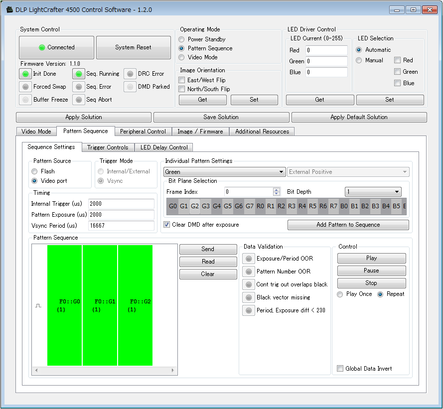

    In our exam, SeqAbort disappeared and 3 patterns are displayed per each vsync under following configuration.
    Internal Trigger : 2000us
    Pattern Exposure : 2000us
    Vsync Period : 16667us
    I am confusing.
    Can you explain the mechanism of Internal Trigger and Pattern Exposure?
    Best regards, RY
  • VSync Period(us) - 16667us in the GUI is just for reference only, this value is never applied to the hardware, we have taken in this our in the latest GUI software. When you configure the device to operate in Pattern Display Mode with pattern source set to Video Port, you must be very careful about effective time that is spent in displaying the patterns during the VYSNC period.
    So,
    Internal Trigger(in us) - 2000us //By the way latest GUI we have changed to appropriate meaningful name as Pattern period.
    Since Clear DMD check box selected, so effective pattern time then become 2000 + 230 = 2230us so 3 such patterns displayed, which will be
    2230*3 = 6690us
    My previous suggestion pattern time was (2500+230) *3 = 8190us
    You can physically measure the VSync period at the source side and make sure it should be > your total pattern(s) display period then only it is a good setup condition.
    Sanjeev

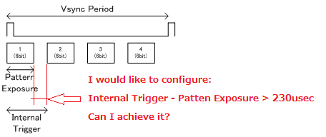

    I would like to achieve following use case:
    Use case 1)
    - Bit depth : 6bit
    - Display 4 patterns in each Vsync
    Q1. Vsync period must be more than total pattens display period.
    Vsync Period > 4 internal triggers in our use case
    Is that correct?
    Q2. I would like to configure:
    Internal Trigger - Patten Exposure > 230usec
    (e.g. Internal Trigger = 5000usec, Pattern Exposure = 2500usec)
    It looks like LCr4500 operate correctly except sequence abort happened.
    But, we must not ignore the Seq Abort status. Is that correct?
    Q3. Do you have any method to configure?
    Internal Trigger - Pattern Exposure > 230usec
    Best regards, RY
  • UseCase - bit-depth = 6 and 4 Patterns per VSYNC,
    so your VYSNC period = 4 x (PatternExposure + Clear DMD after Exposure) // This assumes the Internal Trigger Period = Pattern Exposure
    For example 60Hz - 16667us, the maximum pattern exposure time you can get is 16667 / 4 = 4166.75 - 230 = 3936us
    Q1 - Correct
    Q2 - Sequence Abort status should not be there, although you can see four trigger outs appearing, the last pattern (4th pattern) may not be full exposed.
    Q3 - Keep Pattern Exposure = Internal Trigger and enable Clear DMD after exposure, this is best method.
    Regards,Sanjeev
