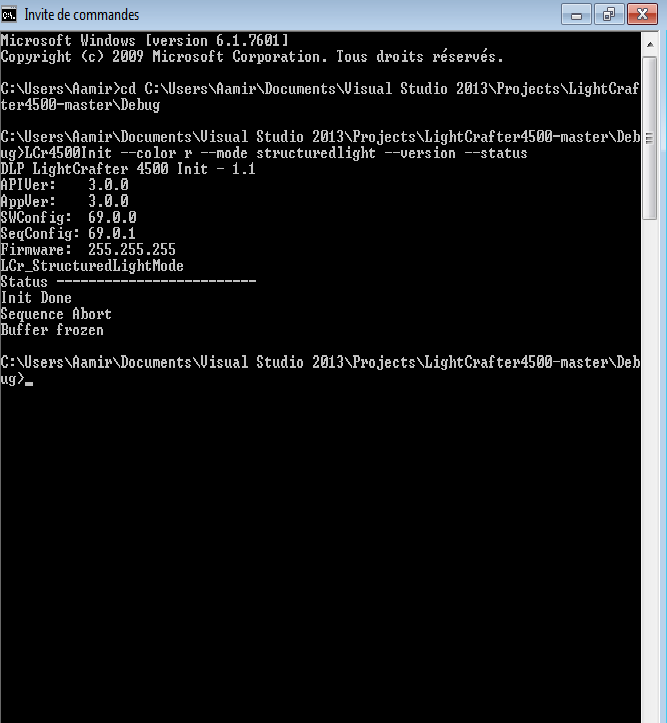

Hey,
Here is my code which I am using to structure my pattern sequence and send it to the DLC350. I am calling APIs in this block and then calling this block in the main.
I want to display 24 1-bit patterns in a sequence. I am using flash drive as the input source. My 24 bit image is stored at the index 3 of the flash drive.
I  have a good idea about the structure of my code, but when I am running it my code is not displaying the patterns and not showing sequence running in the status.
Can someone have a look at my code and tell me what I am doing wrong. I understand that it a bit of a work to read my code, however it will be a great help if someone can give me a feedback.
Aamir

    if (LCR_SetMode(true) < 0)                     // Pattern display mode
        printf("Error LCR_SetMode\n");
        return;
    if (LCR_PatternDisplay(0) < 0)                // Stop Pattern Display
        printf("Error LCR_PatternDisplay\n");
        return;
    if (LCR_SetInputSource(2, 1) < 0)            // Flash, 24 bit
        printf("Error LCR_SetInputSource\n");
        return;
    if (LCR_SetPatternDisplayMode(false) < 0)    // Splash Memeory
        printf("Error LCR_SetPatternDisplayMode\n");
        return;
    LCR_ClearPatLut();
    for (int j = 0; j < NumberOfLutEntries; j++)
        if (LCR_AddToPatLut(
            LutEntries[j].TrigType,
            LutEntries[j].PatNum,
            LutEntries[j].BitDepth,
            LutEntries[j].LEDSelect,
            LutEntries[j].InvertPat,
            LutEntries[j].InsertBlack,
            LutEntries[j].BufSwap,
            LutEntries[j].trigOutPrev
            ) < 0)
            printf("Error LCR_AddToPatLut for index: %d\n", j);
            return;
        printf("Pointer id: %d\n", &LutEntries[j]); // priniting memory addresses of member of  LUT table
    if (LCR_SetPatternConfig(
        NumberOfLutEntries /*numLutEntries*/,
        1 /*repeat*/,
        NumberOfLutEntries /*numPatsForTrigOut2*/,
        1 /*numSplashLutEntries*/) < 0)
        printf("Error LCR_SetPatternConfig\n");
        return;
    if (LCR_SetExposure_FramePeriod(EXPOSURE_PERIOD /*unsigned int exposurePeriod*/, FRAME_PERIOD /*unsigned int framePeriod*/) < 0)
        printf("Error LCR_SetExposure_FramePeriod\n");
        return;
    if (LCR_SetPatternTriggerMode(1) < 0)        // Internal triggers pattern
        printf("Error Sending trigger Mode\n");
        return;
    if (LCR_SendPatLut() < 0)
        printf("Error LCR_SendPatLut\n");
        return;
    unsigned char splashLut[1];
    printf("splashLut: %d\n", &splashLut[0]+45);        // Memory offset of 45 with the mem address of LutEntries[1]
    if (LCR_SendSplashLut(&splashLut[0]+45, 24) < 0)
        printf("Error Sending Image LUT");
        return;
    unsigned int status;
    if (LCR_ValidatePatLutData(&status) < 0)
        printf("Error validating LUT data\n");
        return;
    if (LCR_PatternDisplay(2) < 0) //Start pattern display
        printf("Error starting pattern display\n");

  • This is the screen shot of the command line showing the status I am getting when I run my program.
  • Print the Status;
            return;
    This should tell if the Status is not showing any error.
    Since the API you are using for older firmware build, I suggest to revert to v2.0.0 firmware or you can rebuild the exe using the APIs from the GUI v3.0 (note APIs name changed LCR_xxx to DLPC350_xxx ) onwards.
    Sanjeev
  • Hey Sanjeev,
    Thank you for your reply.
    Yes I am doing that, the print status code is there in my program. Maybe there is a firmware issue. What is the difference between v3.0 and v2.0, apart from the name of course?
    Aamir

  • Hey Sanjeev,
    No I am not seeing 0x00. In my command line window all I am seeing is the same as the screen shot I posted before.
    Now I am writing my main by calling APIs from firmware v3. Let's see if it works. Because I have uploaded a new firmware in to the DLP with my image stored at the index 3 of the flash. However, the version of the firmware is 3.0. So may be that is the problem.
    Aamir
