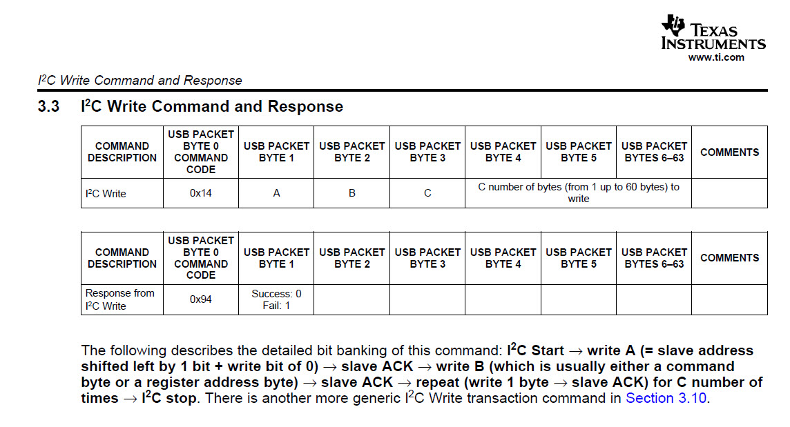

  • Pete,
    First - Hello. Welcome to DLP and MEMS E2E. Sorry you have been having difficulty getting started with the Pico Kit V2. Maybe some answers to your questions will get you going.
    1. I2C pull up resistors - I recommend 2.2k
    2. I2C speed - 100k
    3. Sorry - I'm not familiar with the GUI you are using (I can see its from TI, but I haven't used it). But - yes. The GUI is doing some formatting of the output. The I2C command is the way you describe it. Is there a configuration where you set the I2C address?
    4. The Pico Kit V2 I2C address is 0x36 for writes, 0x37 for reads. The 0x1B which you have seen is when using the bus3-i2c tools in Angstrom Linux.
    5. The BeagleBoard is indeed an excellent way to interface to the Pico Kit V2. But - not the only way. The BeagleBoard has HDMI (DVI-D) video output which can be connected directly to the Pico Kit V2. The HDMI connection includes an I2C channel which is intended for use by the EDID to identify the resolution required. However, the same I2C can be used to communicate with the Pico Kit V2 by using the bus3-i2c commands from Linux.
    6. If you did not have proper pullup or I2C address or bus speed, that is what you would see.
    I hope this helps.
    Pascal

    The primary problem was a transformation of the USB Programmer's entry address that was applied to what was sent to the Pico unit.  It was compounded by an inconsistency in the use of  decimal versus hexadecimal notation by the GUI applicaiton.  A page from the programmer manual below describes a left shift to the entered address and zeroing of the Write bit.  Furthermore the GUI Device Address entry is in decimal notation, where as all other fields are noted as hexidecimal.  This lead me to initially believe the device address was hex as well.  The combination of the translation and decimal notiaton lead to confusion.  In any case a Device Address entry of  27d translates to a 0x36 being sent to the Pico and allowing for successul writes.
