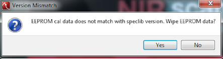

NIRscan Nano EVM users, please be advised that the v2.0 GUI software previously released on ti.com has been found to have an error in the upgrade process. In some cases, it may show the following error message:
If you have already downloaded v2.0, please do NOT click ‘yes’ to this message during the upgrade process. If you have completed this upgrade already and clicked 'Yes' to wipe the EEPROM data, please send me a friend request through this forum and we will work to resolve this issue with you.
To guard against this affecting additional customers, we have temporarily removed v2.0 from ti.com to prevent users from inadvertently erasing calibration data. We will repost the corrected software as soon as possible. Thanks for your patience.
