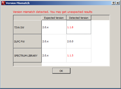

I would like how to update TIVA software.
I have this dialog message:
I dont found the .bin 2.0.0 versione for TIVA.
And I dont know how can update spectrum library.
Can you help me?
Thank you.
Paolo

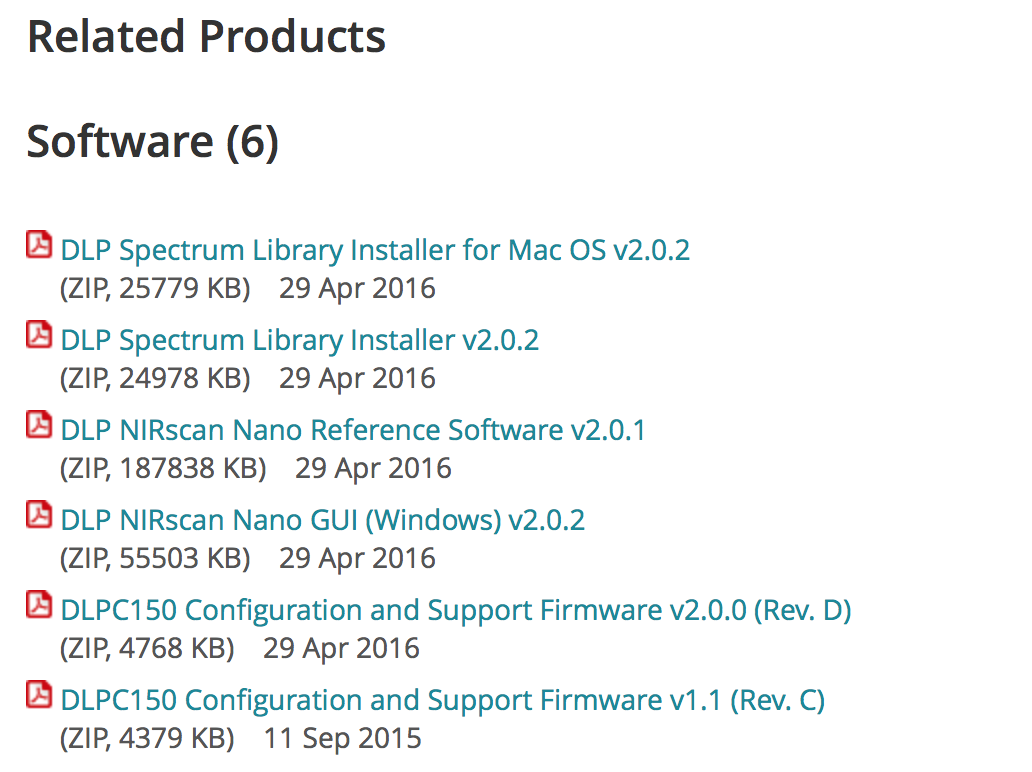

Hi Paolo,
It looks like you are trying to upgrade to version 2.0 with the v2.0 GUI, have already updated the DLPC150 firmware, but have not yet located the Tiva v2.0 firmware?
This firmware is not located in the 'Available Versions' section depicted below:
Instead, it is available in the 'Software' section further down on the NIRscan Nano page:
You will want to download the DLP Nirscan Nano Reference Software v2.0.1 bundle. This will include the .bin file for upload with the GUI.
The Spectrum Library version will update when you upgrade the Tiva firmware with this .bin file. The Spectrum Library is compiled into the Tiva firmware, so it is shown here for reference to ensure that the GUI will be compatible with the Tiva firmware since both of them use the Spectrum Library.
Hello Paolo,
Please go to the Nano EVM page --> http://www.ti.com/tool/dlpnirnanoevm
Then navigate to the "Software" section and download:
DLP Spectrum Library Installer v2.0.2 --> http://www.ti.com/lit/zip/tidcc49
DLP NIRscan Nano Reference Software v2.0.1 --> http://www.ti.com/lit/zip/tidcc48
(after installing this the *.bin file will be under C:\Program Files\Texas Instruments\DLPNIRscanNanoGUI_2.0.2\Binaries) if it was installed in the default location.)
