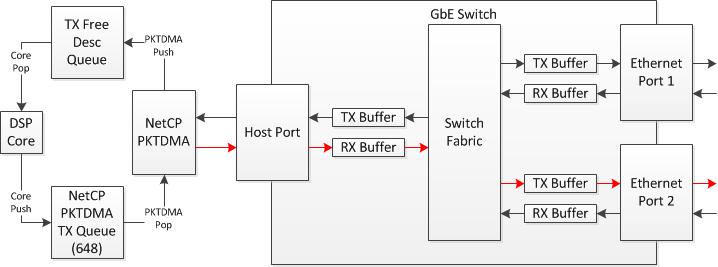

    The GbE switch in the 6678 device is designed to not drop packets that originate at the host port. If a pause frame causes the transmission on an Ethernet frame to be delayed then the TX buffer of that Ethernet port will begin to fill. Once that TX buffer is full then the RX buffer at the host port of the switch will begin to fill. Once that RX buffer is full the NetCP PKTDMA will no longer push data to the host port RX buffer and the packets will remain in the NetCP PKTDMA TX queue.
    Eventually, if the host core continues to generate data while the Ethernet port is not transmitting then the problem will manifest itself by the program running out of free descriptors in the TX free descriptor queue as all of the descriptors will be sitting on the NetCP PKTDMA TX queue waiting for transmission.
    Here is a simplified image of the switch and its buffer that goes with the previous paragraph. Your data path for packet transmission is shown by the red arrows.

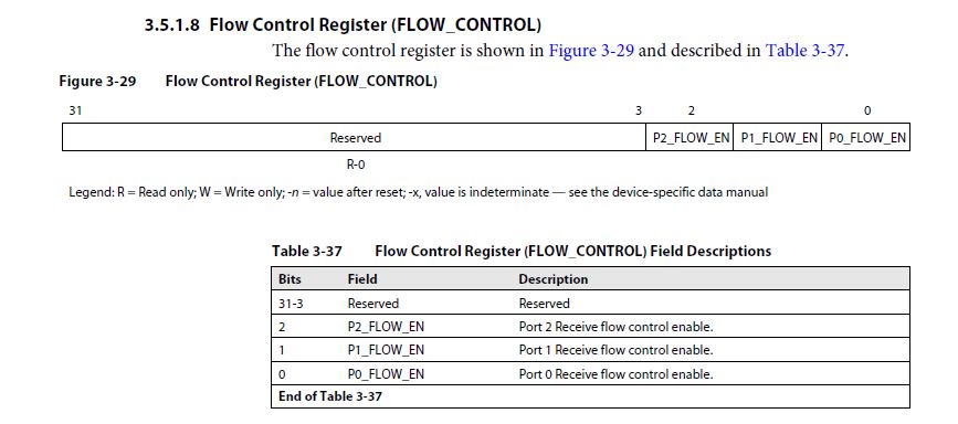

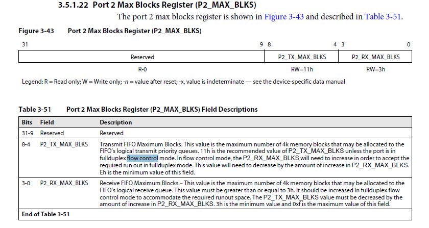

  • Thanks Jason. It is now much clearer for me. I would like to enable flow control on the EVM to see if that is causing the packet loss that I am seeing.
    Flow control by default is disabled on the switch. What shall I do to fully enable it?
    I noticed that there are quite a few registers that are related to flow control:
    For this register (FLOW_CONROL), what is the difference in the behavior of the switch when port 0 (p0_FLOW_EN)  receive flow control is enabled or disabled?
    For this register (P2_MAX_BLKS), the description is unclear to me as to what I should do to configure it properly.
    I guess for this one (MAC_CONTROL), I only need to enable the TX_FLOW_EN, right?

    P0_FLOW_EN defaults to 1 in the FLOW_CONTROL register and this enables RX flow control at the host port. This is what causes the pushback behavior that I described in my previous post in which the PKTDMA will stop sending packets to the Host Port RX buffer when it becomes full.
    For your current purposes I think the simplest way for you to test if flow control is your problem is just to enable TX flow control on the Ethernet port that is connected to the external switch:
