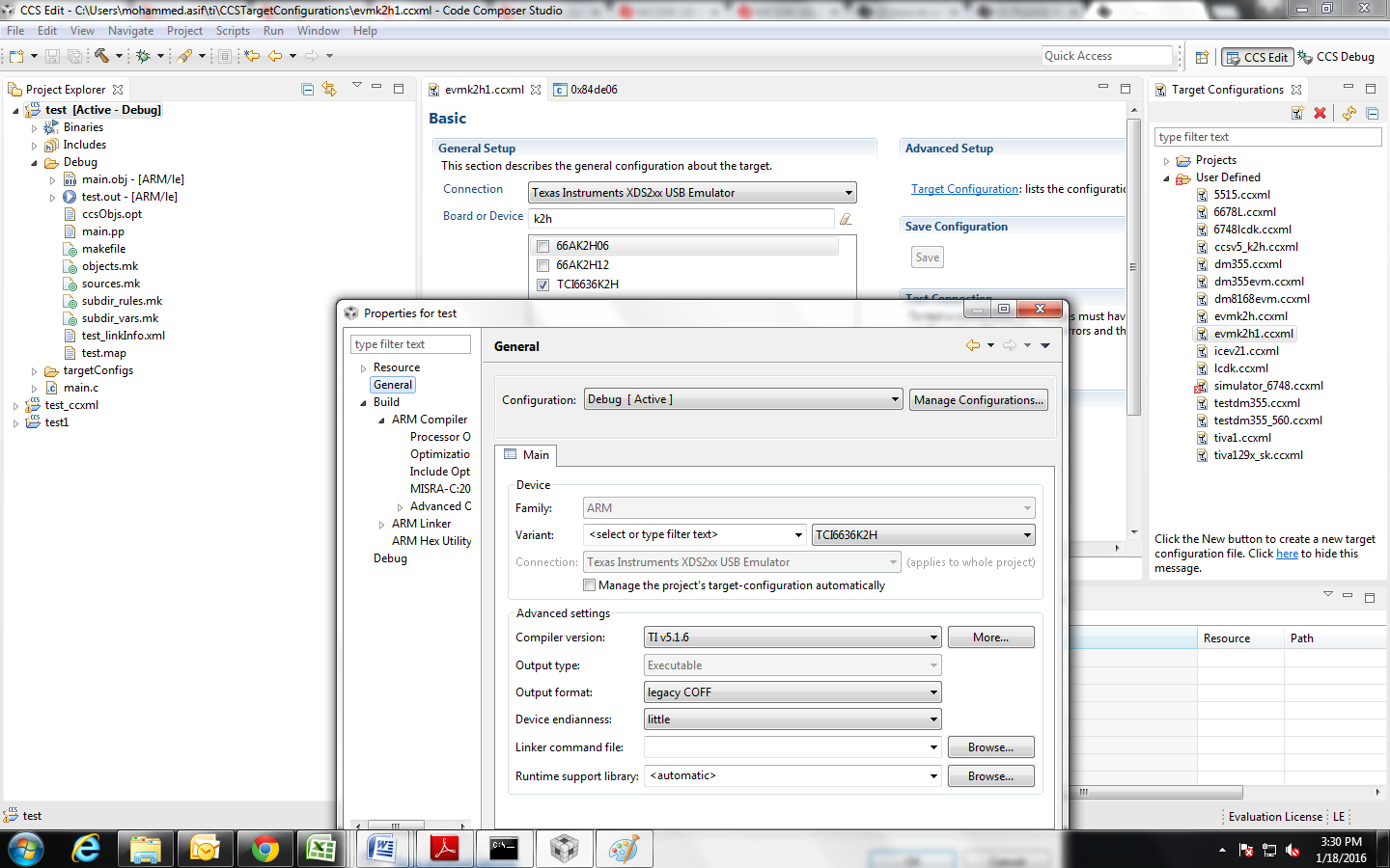

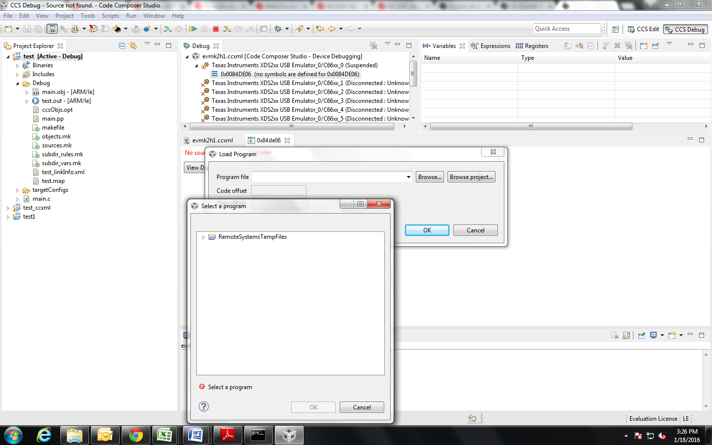

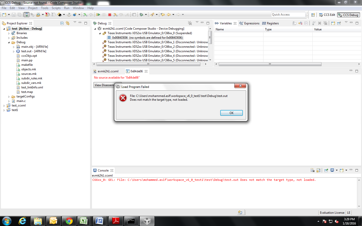

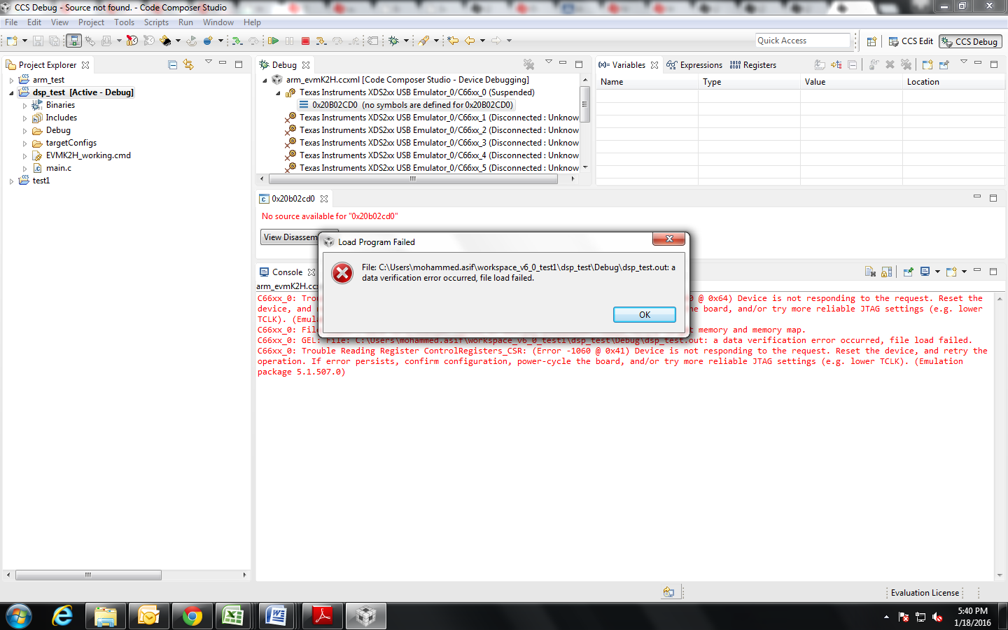

I installed 90 day eveluation licence, how to connect and run basic hellow world program on ccs for evmk2h?
some time i am getting connecting problem and some time loading problem.
i tried with below both target configuration:
connection: texas instruments XDS2xx USB Emulater
board/device: TCI6636K2H
also
board/device: 66AK2H12
i can compile for both TCI6636K2H and 66AK2H12 and generated executable file (.out file) for below basic hello world code.

Dear Titus,
Thanks for the support and your precious time.

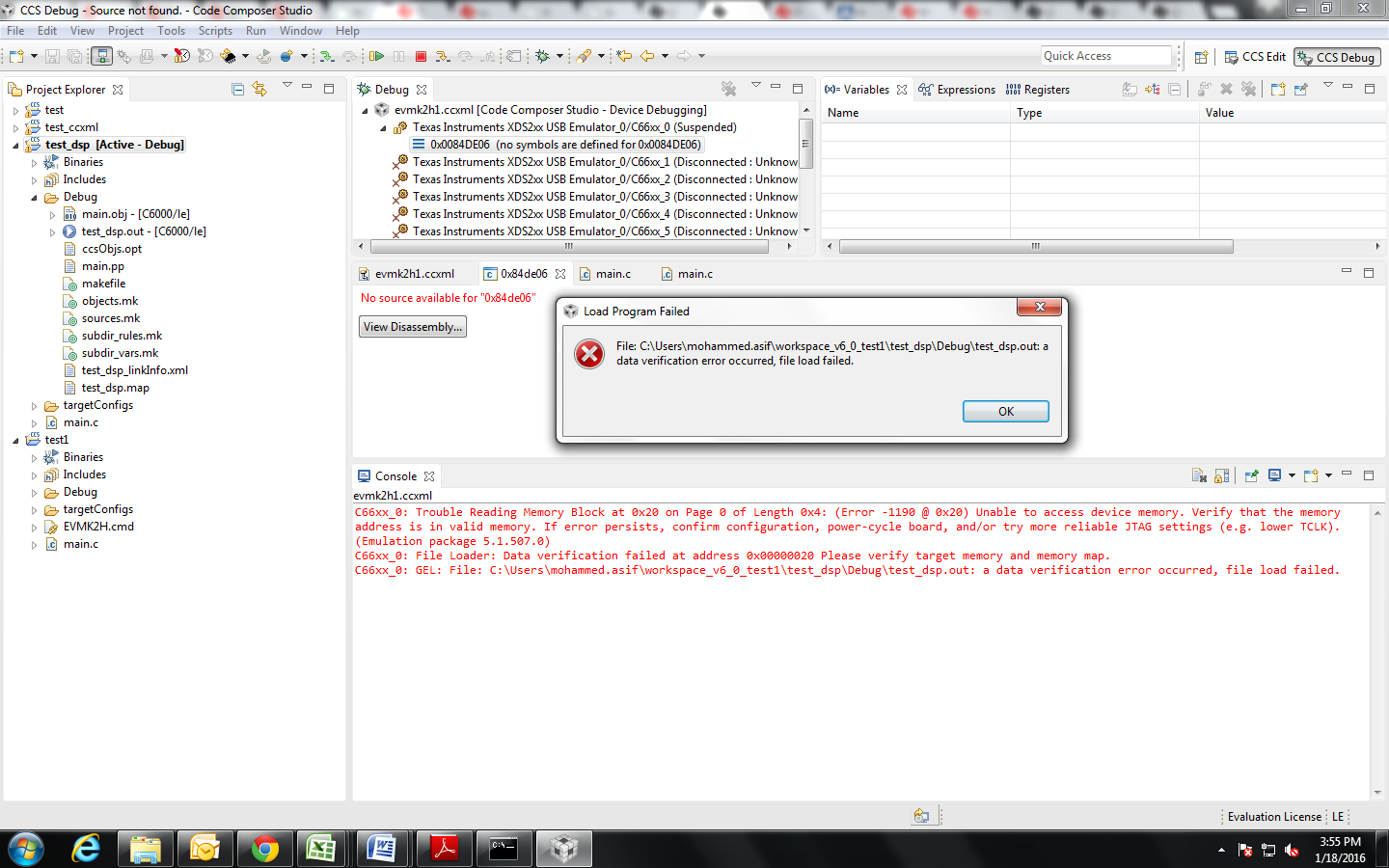

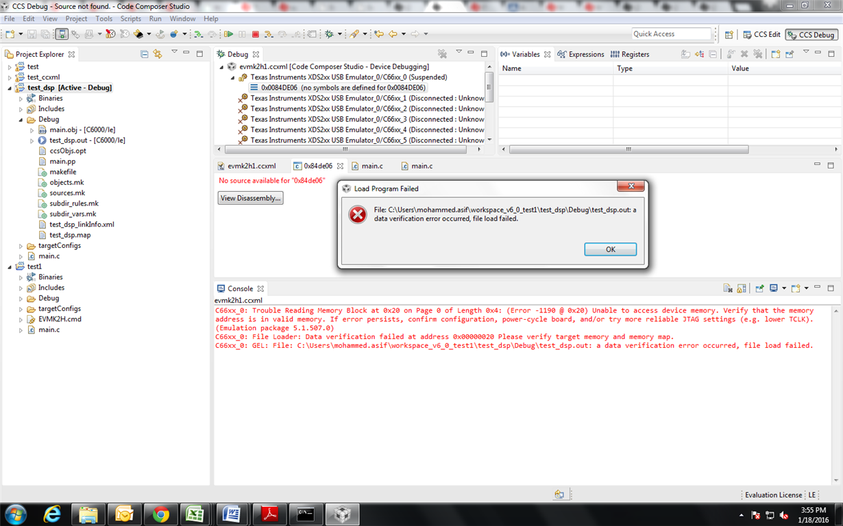

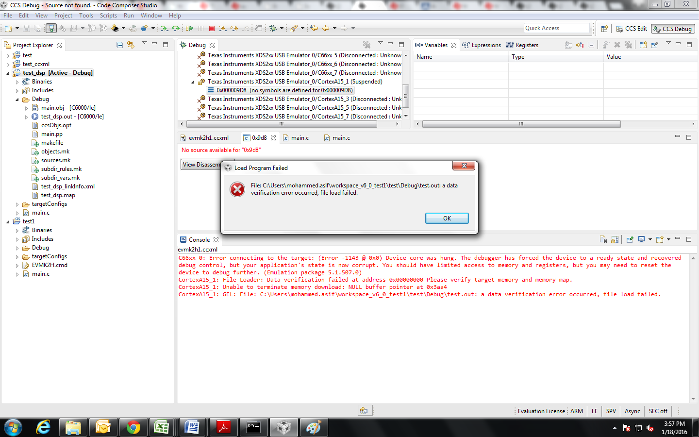

i reset the board and loaded the same .out file but it gives error
I imported C:\ti\pdk_keystone2_3_01_04_07\packages\exampleProjects\aif2CpriFastCMK2HTestProject.
build perfectly without error , got .out file.
but when i loaded and run no output.
