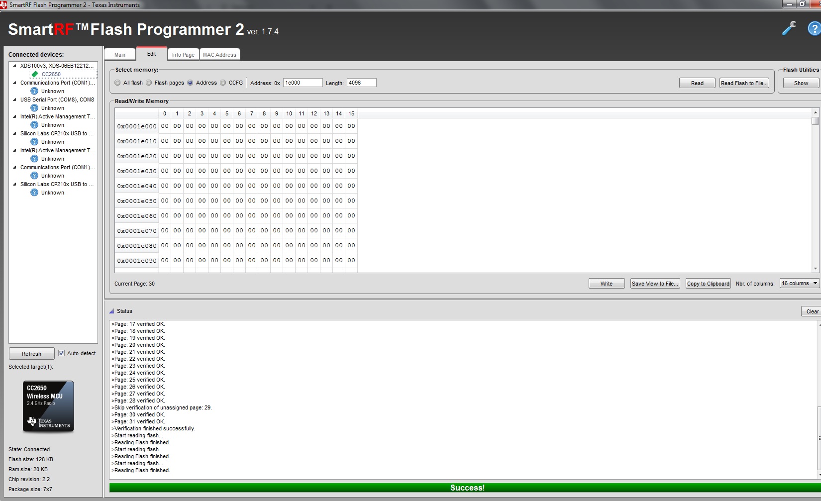

2)After the MASS + Flash Programming, read the SNV location (my case address -> 1e000) using FLASH programer , in that values at (1e000-1e003) is FF FF FF FF .
3)If i do normal prgraming without MASS ERASE, read the SNV location (my case address -> 1e000) using FLASH programer , in that values at (1e000-1e003) is 00 00 10 00 .
(or)
After the first reset (STEP 4) if i  read the SNV Location the (my case address -> 1e000) using FLASH programer, In this case valeus @(1e000-1e003)  changed from FF FF FF FF to 00 00 01 00.
Observation 2 & 3 have any relation with this issue ? because observation 2 shows FF FF FF FF.

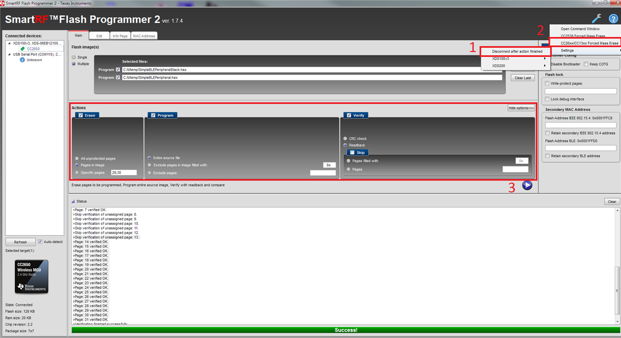

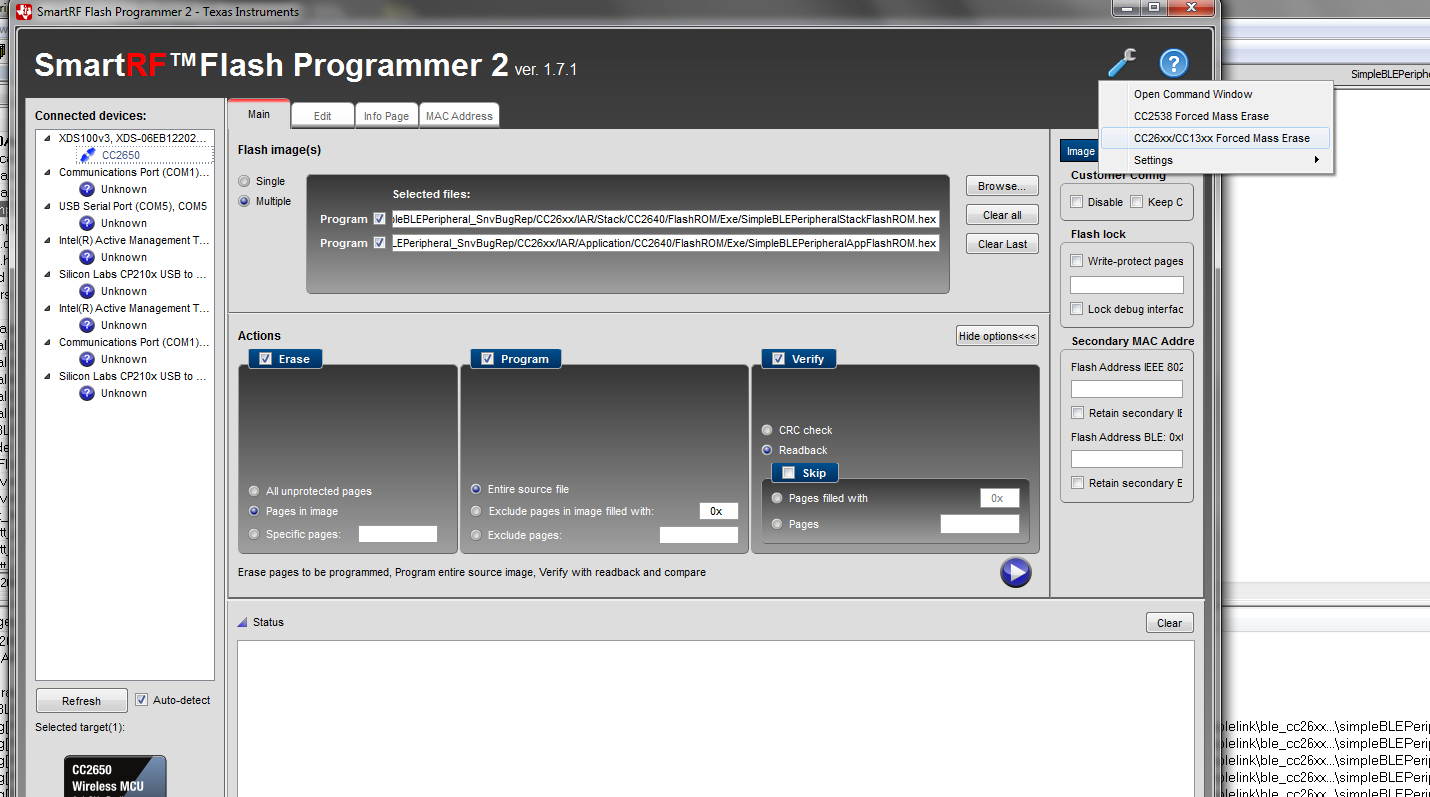

  • Hi JXS,
    The settings remains same except mass erase .Please refer the screen shot.
    We are using the flash programmer 2v1.7.1

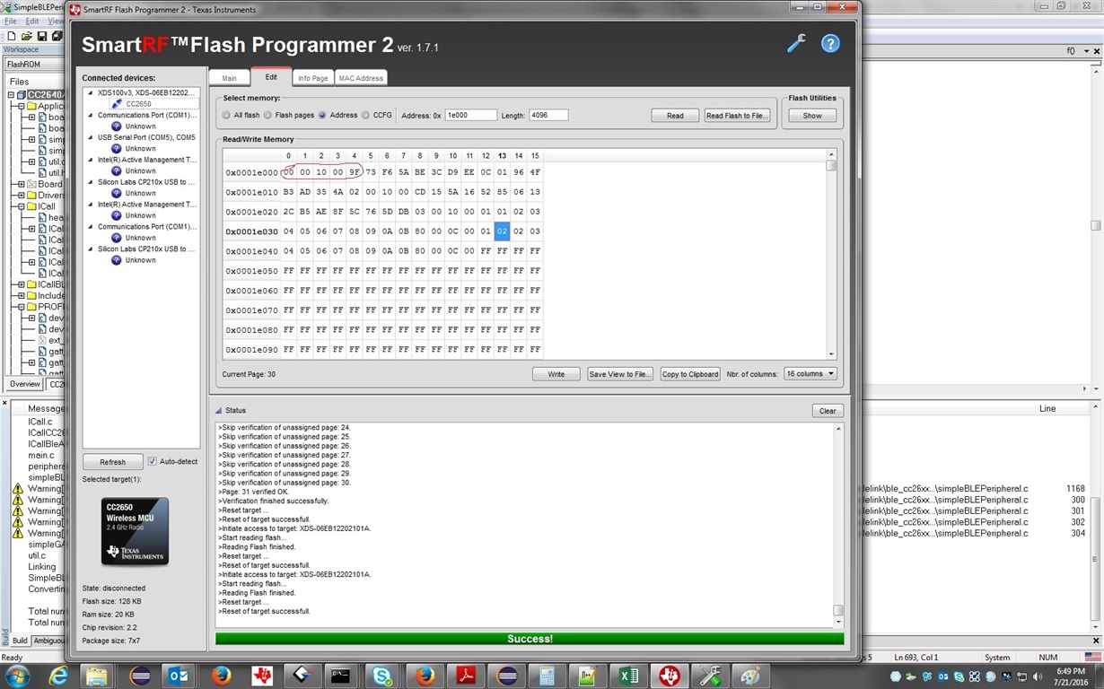

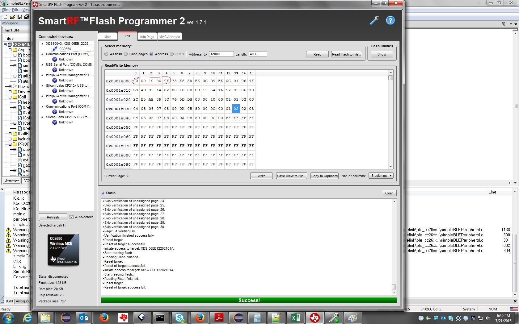

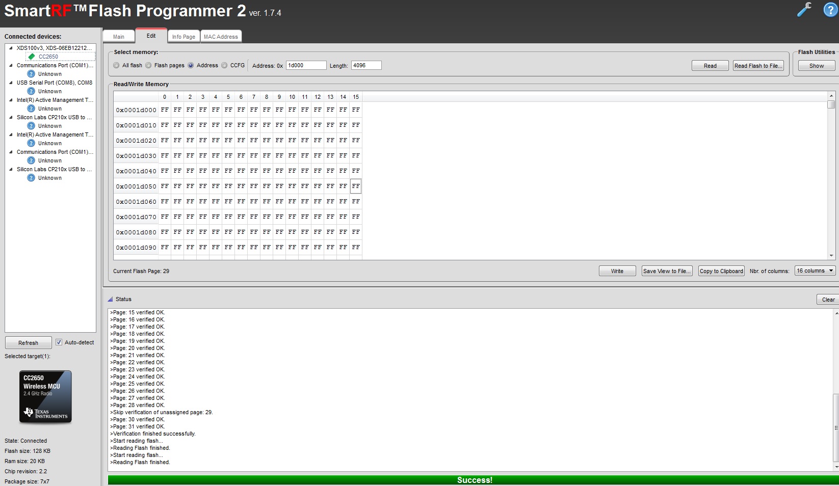

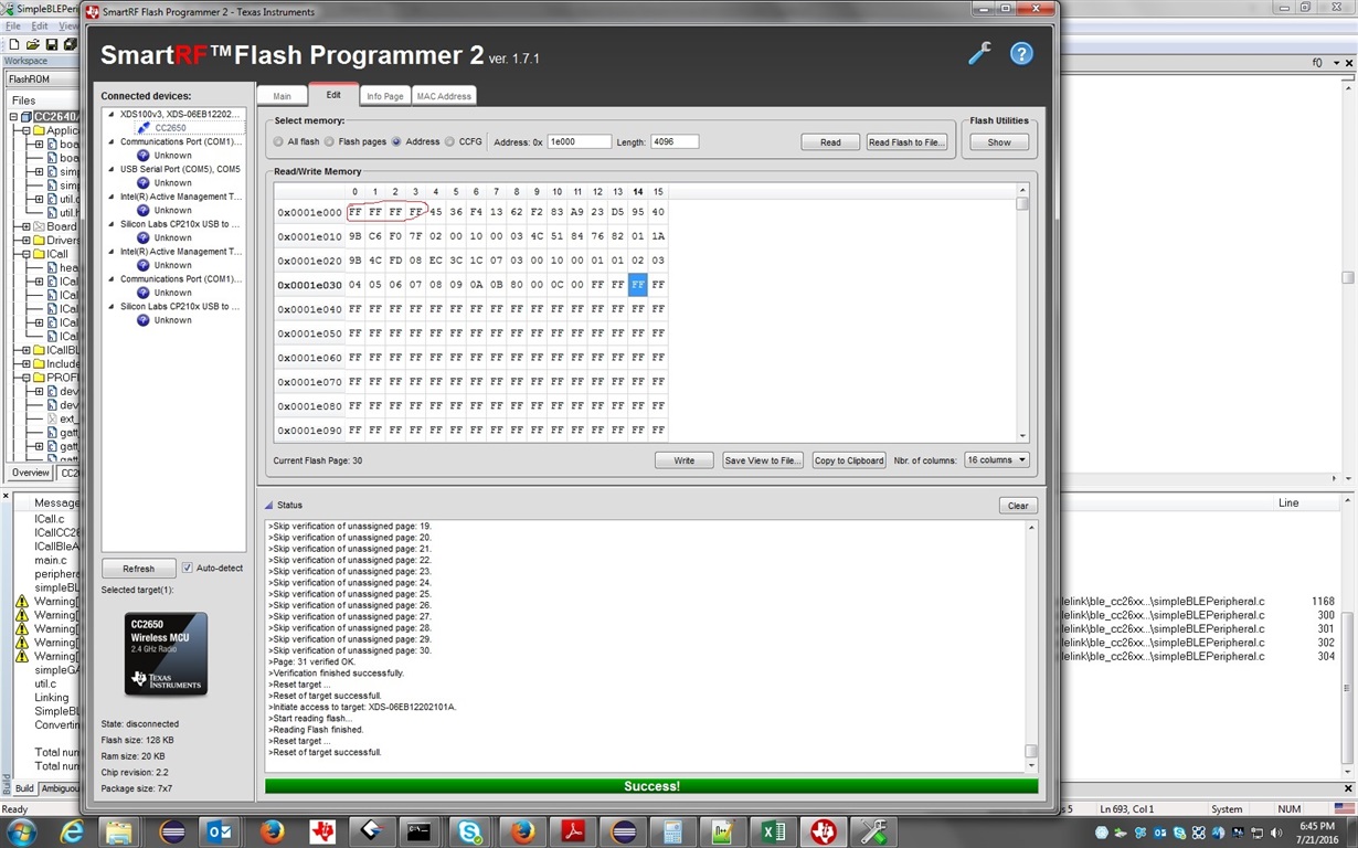

    The stack ends at 1f000. so the last page is used for SNV. Its verified with the SNV write and read.
    Also attached the snap shot of flash layout of after mass erase and flash the App and flash layout of mass erase and flash the App and one more reset.
    find the Test code also in the attachment.

    You mention that you are using 8kB of SNV, or OSAL_SNV=2 ( two 4kB pages). Can you check the value at 0x1d000, this is the address of the first SNV page. The 00 00 10 00 is the header that indicates the page is the active page. What is the value for the first page?
    Note that you can refer to the osal_snv_init() procedure in osal_snv.c.
    Best wishes
  • Hi JXS,
    Thanks.
    Yes. we understood the from the document that if we use OSAL_SNV=2 then Last 4kB will be used for SNV and first 4KB use for compaction process if the 80% of data filled in the Last SNV page. Thats why we are checking in the address 0x1e000.
    Yes. This is True. The value becomes 0 00 10 00 after reset once after mass erase and falsh the App. That showed on the second image.
    But the first image shows the actual problem.FF FF FF FF after mass erase and falsh the App
    Please check and let us know.
  • Hi Thangaraj,
    I noticed from your screenshots you are using SmartRF Flash Programmer 2 v1.7.1. Can you upgrade to the latest version (v1.7.4) to see if this resolves the issue?
    If you follow the steps 1-4 listed in your original post, what value is shown on the LCD after the first reset?

    Hi RachelP ,
    Thanks!
    I have update the SmartRF Flash Programmer  to version v1.7.4. Still i am facing the same issue.
    RachelP [Q] :  If you follow the steps 1-4 listed in your original post, what value is shown on the LCD after the first reset?
    The value of the SNV modified by pressing the RIGHT KEY in SMART RF board, if press one time value will incremented by one and stored to SNV.
    Default Value : 1
    After One RIGHT KEY press  value changed to 2 and stored to SNV.
    After Reset Expected value is : "2"  , But actual value read in LCD is 1  .
    I have attached the Source code of the experiment in this.
    Thanks and regards,
    Jayachandran R
  • Hi Jayachandran,
    I have tested using the file provided and I am not seeing the same issue on my board. If I follow the steps you provided, I see the correct number on the display after the first reset following the mass erase.
    I did see that in your status log, that you are skipping verification of a number of pages that correspond to the stack image. Can you verify that you are reprogramming the stack image and that the SNV area has been completely erased before running the application?
    To check this:
    1. Uncheck the "Disconnect after action finished" Setting
    2. Perform the CC26xx Mass Erase
    3. Flash the device using the settings shown below, your Status log output should show pages 14-31 verified OK.
    4. Read the memory at 0x1d000 and 0x1e000 (the SNV pages) - It should be all F's or all 0's depending on compiler.
    5. Disconnect and reconnect your device and run the application - Is the value retained after reset?

  • Hi Jayachandran,
    For Step 5, I did mean a USB power disconnect. In Step 4, did you see all F's or 0's at 0x1d000 and 0x1e000?
    Another thing you can try:
    After step 4: On the main tab, uncheck Program and Verify, and select "Specific Pages" in the Erase Options. Enter "29,30" to erase just the SNV pages.
    Can you send me a screenshot of your programming settings with the status log output from Step 3 and a screenshot of what you see at 0x1d000 after programming?
  • Hi rachelP,
    Thanks!
    Please find my comments in line.
    [Q] In Step 4, did you see all F's or 0's at 0x1d000 and 0x1e000?
    Yes, i have seen alll FF at 0xd000 page and all 0s at 0x1e000 page.
    [Q] After step 4: On the main tab, uncheck Program and Verify, and select "Specific Pages" in the Erase Options. Enter "29,30" to erase just the SNV pages.
    After Erasing the Page 29(0x1d000) and  (1e000) are changed to FF.
    Followed Step 5, After the reset changed value is persist that means SNV is working fine.
    could please tell me the reason for this erase cycles after the Flash program ?
    Is this issue with SNV (or) expected behavior of the SNV? Since we are using this SNV with production code.
    if it is a issue when it will be fixed?
    Without this additional step, can we solve the problem in stack?
    Thanks and Regards,
    Jayachandran R
  • Hi Jayachandran,
    I noticed in your screenshot that your log shows "Skip verification of unassigned page 29". This corresponds to the first SNV page. When I run your code with the example SimpleBLEPeripheral stack I am not seeing the same problem and my page 29 is verified ok. There may be an issue with the way you are building the stack. Can you check your hex file to make sure page 29 exists?
    If you follow the steps above that allowed you to run the program successfully, what is at address 0x1d000 after the first reset?
    If you check the "All unprotected pages" box instead of "Pages in image" in the Erase settings, does the SNV work as expected?
  • Hi rachelP,
    Thanks!.
    Yes, page no : 29 is not exist in the stack hex file, since I am not changed any settings and source code during the stack hex build, i made only change is OSAL_SNV = 1.
    Whatever hex build i send to you previously with the Settings OSAL_SNV=1 (since my production software also using the same), if i set OSAL_SNV as default value that is 2, then SNV is working as expected so the problem is not occurring,
    so the problem persist with setting OSAL_SNV = 1 [4KB for SNV page].
    My bad, sorry! for the wrong information provided by me in the initial times of this forum thread,  so here after don't considered about the configuration OSAL_SNV=2, because i need solution for OSAL_SNV=1.
    [Q] If you follow the steps above that allowed you to run the program successfully, what is at address 0x1d000 after the first reset?
    I thing this step not need for OSAL_SNV = 1.
    [Q]If you check the "All unprotected pages" box instead of "Pages in image" in the Erase settings, does the SNV works as expected?
    But i  followed Step 5, After the reset changed value is persist that means SNV is working fine.

    Thanks for clarifying that you are using OSAL_SNV=1. I will look into what could be causing your issues with the 4KB SNV page.
  • Hi Jayachandran,
    The issue is in the way the SNV page is being initialized. You can watch this behavior if you step into the NVOCOP_initNV function in nvocop.c. Since the header is set to all 0's, it reads it as being in the Transfer Page State and doesn't initialize the SNV properly.
    To fix this, make the highlighted changes in nvocop.c:
     * LOCAL VARIABLES
    #if defined(__IAR_SYSTEMS_ICC__)
    #pragma data_alignment=4096
    #pragma location = ".snvSectors"
    const uint8 NV_FLASH[FLASH_PAGE_SIZE] = {0xFF};
    #elif defined __TI_COMPILER_VERSION || defined __TI_COMPILER_VERSION__
    #pragma location = (SNV_FIRST_PAGE << 12);
    #else
    #error "Unknown Compiler! Support for SNV not provided!"
    #endif
