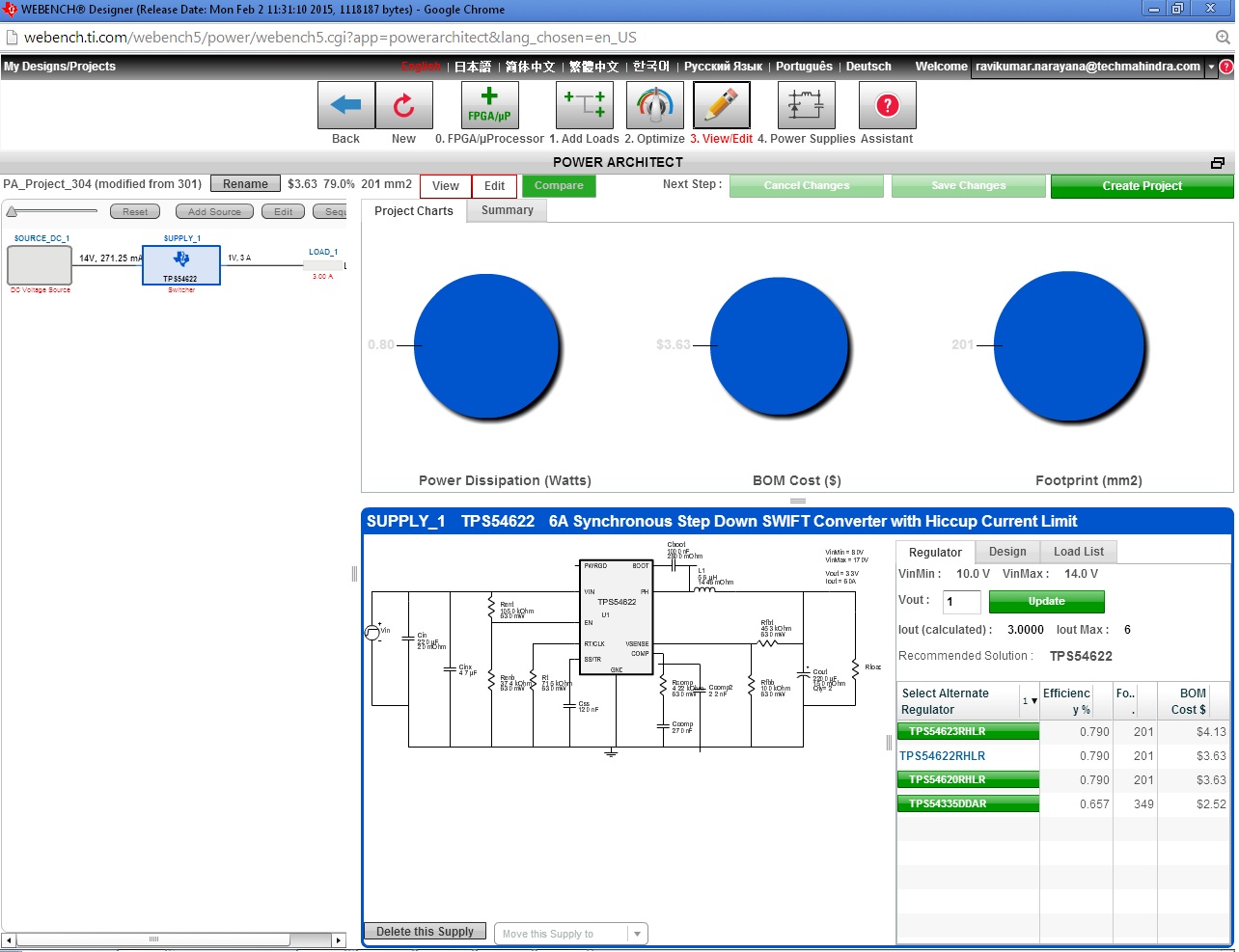

  • Hi Jason,
    Thanks for your reply.
    I tried the steps you had suggested in your response with Power Architect.
    Surprisingly when i tried with power architect for 1V@3A with NO Ripple Filter Option( i.e. Ripple filter Check box Unchecked). TPS54627 didnt appear in the list of Regulators.
    I have attached screen shot of the tool.
    Please let me know what has gone wrong.
    Ravikumar
  • Hi Ravi,
    This is interesting, are the only inputs that you are applying the basic ones (vin,vout,Iout)? If you are not selecting any advance filtering options then i must be missing something.
    Where you able to create the design in the single rail Webench interface?
    -Jason

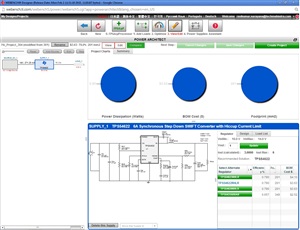

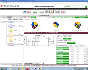

  • Hi Jason,
    Today i observed a strange happening with the Webench Tool.
    Using Power Architect option, i tried to design power supplies with the following requirements.
    Vin= 10V to 14V
    Output Voltages:
    1) Vout = 3.3V, Iout = 5A, Vout (p-p) ripple = 1.5%
    2) Vout = 1.5V, Iout = 1.1A, Vout (p-p) ripple = 1.5%
    3) Vout = 1.5V, Iout = 0.6A, Vout (p-p) ripple = 1.5%, Seperate supply is used
    4) Vout = 1.2V, Iout = 1.3A, Vout (p-p) ripple = 1.5%
    5) Vout = 1.0V, Iout = 4.6A, Vout (p-p) ripple = 1.5%
    6) Vout = 1.0V, Iout = 3A, Vout (p-p) ripple = 1.5% Separate supply is used
    For all the above output voltages, Ripple filter requirement was not checked  in the check box

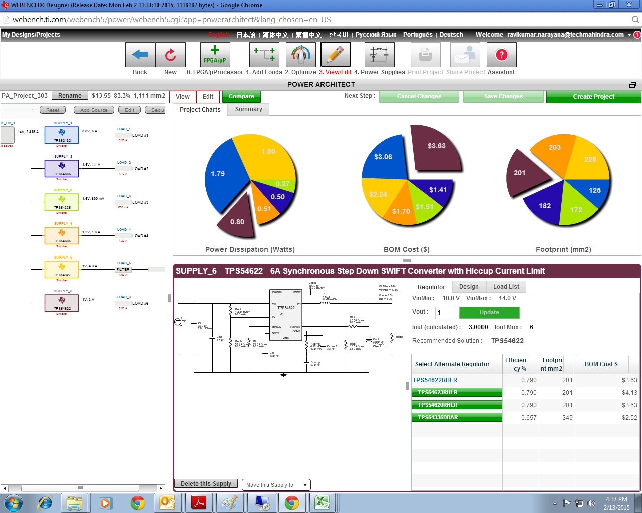

    For the first time when i tried to design this supply, for Vout = 1V@3A, TPS54627 was listed in the Select Alternate Regulator Column. (Power Architect 1V@3A.jpg)
    When i tried repeating the same design for the second time with identical inputs, surprisingly, for Vout = 1V@3A, TPS54627 was not listed in the Select Alternate Regulator Column. (Power Architect 1V@3A _1.jpg)
    Can you please take a look at this and explain if something went wrong from side?
    Ravikumar
  • Hello Ravikumar,
    We have seen this issue of inputting the same inputs and getting different outputs in Power Architect. Power Architect has a complex solution selection flow. We parallel this flow to increase the speed of the system and get the results quicker. Due to the multiple threads running at the same time the flow will return results in a non-deterministic order. Since these solution threads can come back in different orders every time you generate a design there is no guarantee that the same solution will be the number one best every time.
    We are aware that this is frustrating but we can guarantee that every design that does get created is valid every time the solution set is generated.
    We apologize for the inconveniences.
    -Jason
  • Hi Ravi,
    I was unable to recreate this issue, I am currently working to try to find the root of this problem. As for the time being if you only have one load that you are trying to design a solution for I recommend using the single load designer.
    -Jason
