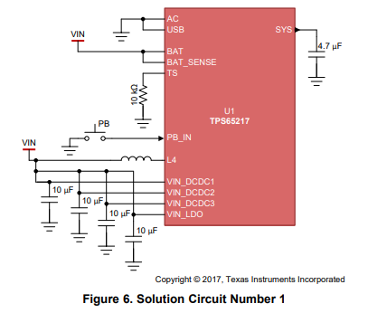

  • The App Note you mentioned does not say to connect a 10-uF capacitor from BAT and BAT_SENSE to GND to solve the issue.
    As you can see in the below picture, the problem is resolved with a 10-kOhm resistor labeled RLL (light load).
    The purpose of the BAT pin is to connect a single-cell Li-Ion or Li-polymer battery. The TPS65217 PMIC can charge the battery using power from AC (an AC-DC adapter producing 5V DC at high current) or USB (5V limited to 500mA) and use the battery as a power supply to the system. The BAT_SENSE pin is to detect the presence of a battery and the voltage on the battery to determine which part of the charging cycle to enter. Leaving the BAT_SENSE pin floating without it being shorted to the BAT pin does not help the PMIC determine there is no battery. The BAT and BAT_SENSE pins must be shorted together. If they are shorted together and left "floating" with a 10-uF capacitor, then this capacitor will get charged by the voltage on the SYS pin when the AC or USB power is removed. This charge on the capacitor acts similarly to a weak battery, so the device digital + analog detection is still running and able to detect AC removal. If AC browns-out and returns to a normal voltage while this capacitor is still charged, then AC removal never occurred and there will not be a wake-up event to return to the ACTIVE state. The 10-kOhm resistor to GND instead of a 10-uF capacitor prevents this build-up in charge and the problem does not occur.
    The problem generally arises from not using a battery in the system. The PMIC is designed to work with a battery, but the Beagle Bone Black reference design does not include a physical battery when it is shipped because shipping Li-Ion batteries is difficult for legal reasons. Most people assume the battery is not required. The PMIC can work without a battery, but it requires some additional consideration. This is the purpose of the App Note.

  • Hayashi-san,
    Yes, it is quite simple to use AC as the only power into the TPS65217 PMIC to get OVP protection benefits.
    Solution Circuit Number 2 for Case A (No Battery) is shown in Figure 7 on page 9 of SLVA901, and this will work for the majority of applications. All the customer needs to do is short BAT and BAT_SENSE together and then pull-down to GND with a light loading resistor (1-10kOhms) which will ensure there is no charge build up on BAT pins when AC is removed.
    If customer's system requires VIO of the PMIC to be provided by a separate discrete DC-DC converter or LDO, then the resistor will not work because VIO > VAC and there is a leakage path through the TPS65217 that will pull up the BAT and SYS pins. This is Case B on page 6 and can be resolved in a different way:
    Solution Circuit Number 3 for Case B, shown in Figure 10 on page 10.
