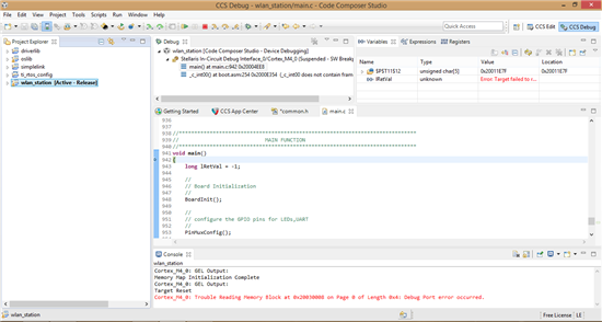

  • Yes i meant that led's. Is it normal.
    I also tried to run the wlan station program i had following error.
    What shall i do?
    Thanx
  • Hi Niraj,
         From your CCS screenshot, you have a exclamation at wlan_station, meaning you got some warnings when you build it. I suggest you fix those warnings first before trying out the wlan_station.
    - kel
