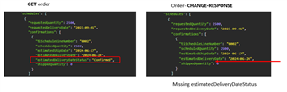

  • Hello Faye
    We have noticed that when calling the change orrder api we have noticed that "estimatedDeliveryDateStatus" is missing in the "confirmations" could you please also try to look at this as well. We get the status when we call the get order api.
    Appreciate your help.
    Abdulrafay
  • Hi Abdulrafay,
    I have confirmed this problem and have submitted it to be resolved.  I will let you know when it will be released.  Thank you for catching this!

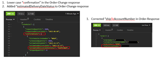

  • Hii Abdulrafay,
    We've address three of the four defects you reported:
    1.  Corrected "confirmation" attribute in Order-Change response
    2.  Corrected shipToAccountNumber" attribute in Order-Create response
    3.  Added  " estimatedDeliveryDateStatus" to Order-Change response
    The last item (adding "success" error message structure) will be a bigger effort, as the error messaging is designed around "errors", not successful calls. We are discussing options, but, this will take longer to resolve and I do not have a timeline on when that will occur.   Because of this, I am moving forward with closing this ticket, but, I will keep you posted on this item and I have added your name and this E2E thread # on the ticket as well.
    Please let us know if you need anything else.
    Faye
