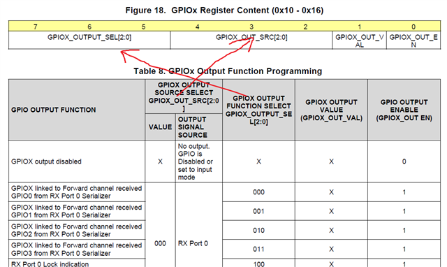

Could you please verify the configuration code for 935+936 I2S transmission, 935 GPIO0/1/2 as input and only 1 camera in port0, 936 GPIO0/1/2 as output? We tried below code but it doesn't work.
936 >>>Write:
0x4C=0x01
0x0F=0x7D
0x10=0x01
0x11=0x05
0x12=0x09
935 >>>Write
0x33=0x07
0x0D=0x80
0x0E=0x87
Read back 0x53 (check input pin status)=0x02
Read back 936: 0x59=0x6b, 0xDC=0x02 and 0x0E=0x10 (check output pin status)
