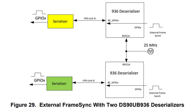

Hi Team,
As title, my target is let DS90UB936-Q1 GPIO6 map to DS90UB935-Q1 GPIO0. Can you help check my setups? Thank you.
y=6 and x = 0
1. Set 936GPIO6 as input type. (default is input type, we don't need to extra action.)

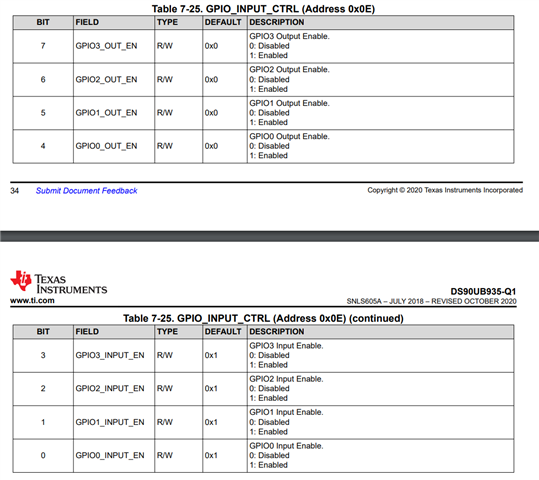

2. Assign 936GPIO6 state to BC_GPIO0_SEL, 936 0x4E[3:0] = 0110.
3. 935 GPIO0 set output type. 0xE[4]=1 and 0xE[0] = 0
