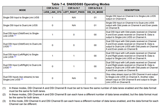

Dear team,
My customer has an application that needs to choose one of two channels MIPI signal and then convert it to LVDS, a 2:1 MUX and converter application. I checked the datasheet but seems like SN65DSI85 only has dual DSI input(with Odd pixels received on Channel A and Even pixels received on Channel B) and single LVDS output. Can this part be configured to receive an independent DSI on channel A and another DSI on channel be, then choose A or B to convert to single channel LVDS? Or de we have other devices with similar function? Customer is using LONTIUM SEMICONDUCTOR LT9211
