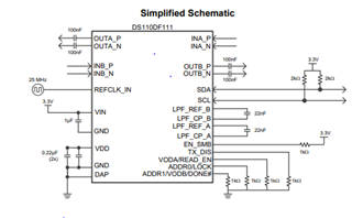

  • Hi Felix,
    The DS110DF111 may be used for 10G SFP+ ZR applications. We have OEM customers already using this retimer part numbers for that application case. If you are only using retimer on ingress path then a single DS110DF111 would technically be sufficient for two SFP+ ports. However, one potential issue would be that your board routing might a bit unideal as the retimer channels would be oriented differently. As seen below channels A and B have their respective Rx and Tx pins on opposite sides of the chip. if you can live with this issue then DS110DF111 could be option for you.
