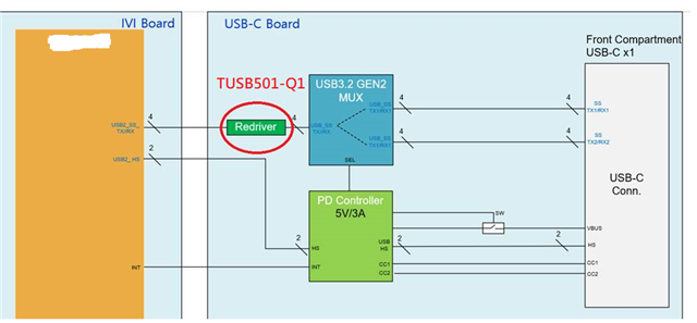

our customer IVI and USB-C function block as below chart, about Redrive on daughter board have any concern?
if any suggestion, Please advise me.

    Is this an automotive design application? The block diagram shows a USB3.2 Gen 2 MUX, but the IVI Board Host shows only one pair of TX and RX.
    For non-automotive, TUSB542 would be a more appropriate solution.

    Yes. This application is for Automotive,  about Redrive on daughter board have any design concern?

        Nice to meet you, This is Automotive FAE Roy which co-work with Disti FAE Lawrence , customer will design USB PD mux HD3SS3212-Q1 with support USB3.2 Gen2 10Gbps Mux but due to cable is too long (~1m cable length) they will design re-driver , but currently we just only have TUSB501-Q1 Automotive grade redriver only support 5Gbps solution now.
        do you have 10Gbps automotive grade re-driver solutions? May I know if customer design  HD3SS3212-Q1
    + TUSB501-Q1 application is only support up to 5Gbps speed max ?
    thank you for your help.
    Roy

    TUSB501-Q1 will only able to support up to 5Gbps.
    Let me check with my marketing team on the schedule for 10Gbps automotive grade re-driver and reply back to this e2e thread.

    The block diagram itself looks ok. You are using the resistor divider network to restore the common mode voltage for HD3SS3212-Q1. With HD3SS3212-Q1 common mode voltage between 0 to 2V, why do you choose resistor divider network that provides ~0.4V, and not 1V common mode voltage?

      Sorry for late reply. this is just only draft schematic , we will waiting for customer update schematic, will sent to you review again once schedule is confirrm
