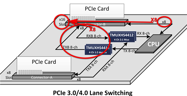

1,TMUXHS4412是否可以级联,是否可以和DS160PR421/DS160PR412级联
2,TMUXHS4412手册ZHCSN19文档中描述的使用场景,x16 slot一个x8经过TMUXHS4412另一个x8没有经过TMUXHS4412,对于X16的卡的pcie稳定性有没有影响?

1: yes, but make sure channel loss should meet PCIe channel loss spec.
2: it should not affect performance, each PCie slot is independent.

1,TMUXHS4412是否可以和TMUXHS4412级联?
2,TMUXHS4412是否可以和DS160PR421/DS160PR412级联?
3,TMUXHS4412手册ZHCSN19中的X16 SLOT是由两个X8组成的,这两个x8一个x8经过TMUXHS4412另一个x8没有经过,这个对link为X16有没有影响?
Channel 0&1 go through different impairments vs. channel 2&3. This could work but it could highly be dependent on the CPU and the SSD plugged into the M.2(interoperability based on different CPU and SSD). As long as this is a closed system and customer does his due diligence to check this operation and has good margin, it should be ok.

我的问题是:
有风险你可以说出来我们评估,请正面回答问题,你看下交流记录,你这么回复这个方案不敢用啊,5天了没有有效的答复
of course TMUXHS4412 can cascading with each other. For PCIe gen4 at 8Ghz, insertion loss of each TMUXHS4412 is -1.3db ,so just to remember each 4412 will add 1.3db loss when they are cascading.
yes, TMUXHS4412 can cascading with redriver like DS160PR421/DS160PR412
3,TMUXHS4412手册ZHCSN19中的X16 SLOT是由两个X8组成的,这两个x8一个x8经过TMUXHS4412另一个x8没有经过,这个对link为X16有没有影响.
The 8 channel with mux will add delay and insertion loss. Delay will not cause link issue. but insertion loss may cause issue, if the channel has enough loss margin, the system should be pretty stable.
Hope the above reply can answer your question.
