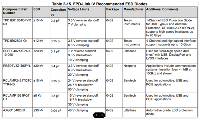

Which position is recommended for placing the RIN+/- anti-static diode or TVS of DS90UB924-Q1?
What kind of anti-static devices are more suitable for selection?

We do not have any current recommendations for anti-static diodes. For ESD diodes, however, the following general recommendations are provided:
For specific component recommendations, see below:

What do you think about choosing a reverse standby voltage 24V device because we need to conduct a short-circuit power and ground test?

Or can we put it this way, is bipolar or unipolar better for TVS recommendations?

Do you mean unidirectional or bidirectional? If that is what you mean, bidirectional is typically better for ESD protection.
