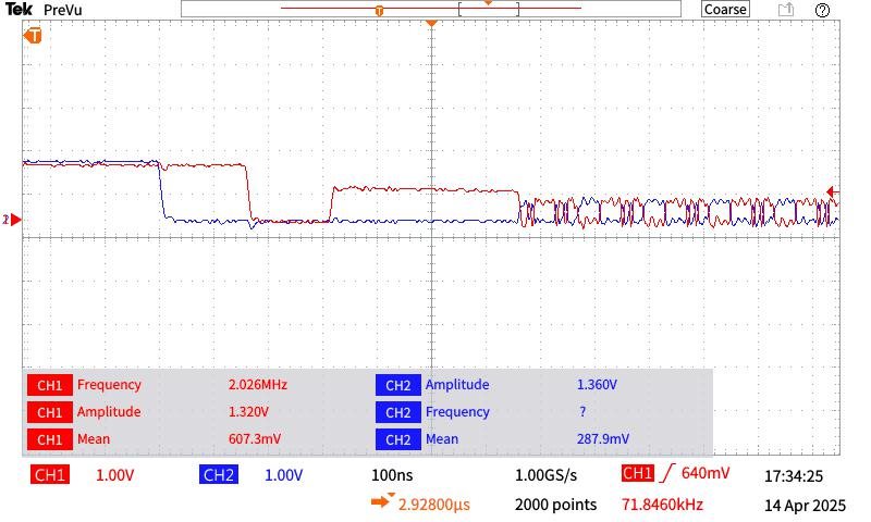

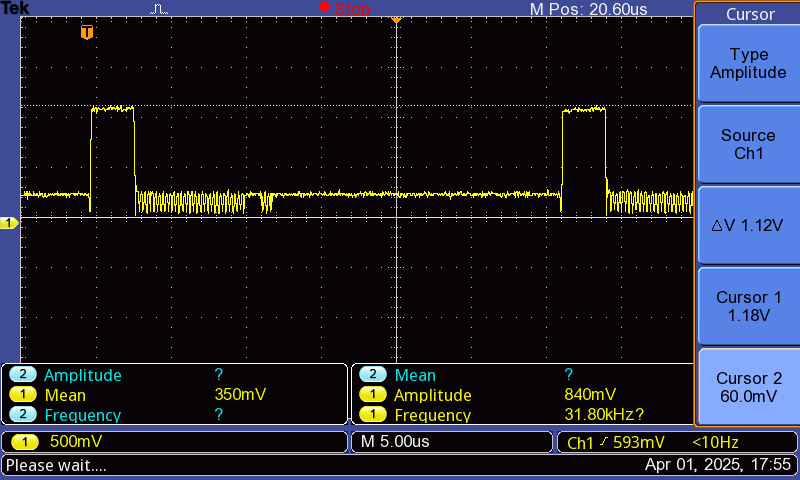

    but i did not got any display expect test patten (test patten also when clock source i selected internal or Internal w/ext. clock not worked on only external).
    If PATGEN with external timing is not working, this either means that the LP11 transitions are not present from the DSI source or the timing from the DSI source is incorrect.
    In the DSI bringup app note for the 941AS, please follow Section 4.2 to confirm if there are missing periodic low power transitions.
    Jack

  • Hi Nikolas,
    I have captured the waveform of data line for DSI as attached below, with the same I have tested with my DSI displ. I am getting video on DSI Display but not on serializer-desrializer display.
    Please analyze and let me no further step to move forward.
    Abhimanyu

  • Hi Abhimanyu,
    The DSI waveform shows that there is no LP11 state entered during the blanking period. Below is an example of how LP11 looks in comparison to the HS data transmission. LP11 is around 1.2v according to the D-PHY standard.
    In the DSI bring up app note, there are two example flags that can be used to see if there is an option in the DSI source driver to enabled LP11 during BLLP.
    There is no workaround for a DSI source that does not enter LP11 at least once per frame during the BLLP period.
    Jack

  • Hi Abhimanyu,
    Thank you for the additional scope shots and the forum link. From the previous register dump I saw that DSI Indirect Register 0x2A was 0. The 941AS DSI receiver is still not able to identify the incoming DSI data types.
    Here is the waveform that i captured and it looks like as expected.
    We are seeing the LP11 state but there can still be issues if the LP11 state does not occur at the right time or if it affects the timing packets.
    Can you try enabling option #2 (DSI_DISP0_LP_STOP_PERFRAME) so that the LP11 state is not entered on every line? Even if LP11 is entered at least once per frame if it occurs at an incorrect spot, it can interfere with how the 941AS determines the incoming video timing.
    Jack

    There Is my mistake in part number of de-serializer
    Earlier I mentioned DS90UH948 but actual part number of my de-serializer is DS90UB926QSEVB that I am using with serializer DS90UB941AS-Q1EVM.
    Require support for corrected part number.
    I am not having access of DSI protocol analyzer I have access of DSO and digital logic analyzer.
    Below are observations as per suggested changes with updated image of scope.
    It looks see LP11 is coming correctly after change MODE_VIDEO_BURST to MODE_VIDEO_SYNC_PULSE.
    IMG-1
    Below is DSI resister log after changing MODE_VIDEO_BURST to MODE_VIDEO_SYNC_PULSE, I am not seeing any difference in DSI resister 0x2A

    Is there any other settings needs to be done in DS90UB941AS or DS90UB926QSEVB, As I am not seeing any video on screen with suggested settings.
    Abhimanyu
  • Hi Abhimanyu,
    From your reply on April 4, I can see that the DSI signals are roughly soldered to the side of the connector. DSI/D-PHY traces require differential routing and I am not confident that this method of soldering between Raspberry Pi and the 941AS EVM will allow for the 941AS to properly decode the DSI signals. Can you confirm this is how the Raspberry Pi is connected to the 941AS EVM?
    The 941AS uses the QSH-020-01-H-D-DP-A connector for the DSI interface. The Raspberry Pi uses a 2× mini 22-pin, 0.5mm (fine) pitch, 11.5mm width connector for DSI interface. I am not aware of a cable assembly that has these two connectors. An adapter board could be made to bridge between the boards.
    From DSI indirect register 0xF (DPHY_STATUS), I see that the data lanes are not active. This indicates that the D-PHY Start-of-Transmission (SoT) sequence is likely not detected.
    I do not have further recommendations for 941AS settings.
    Jack
