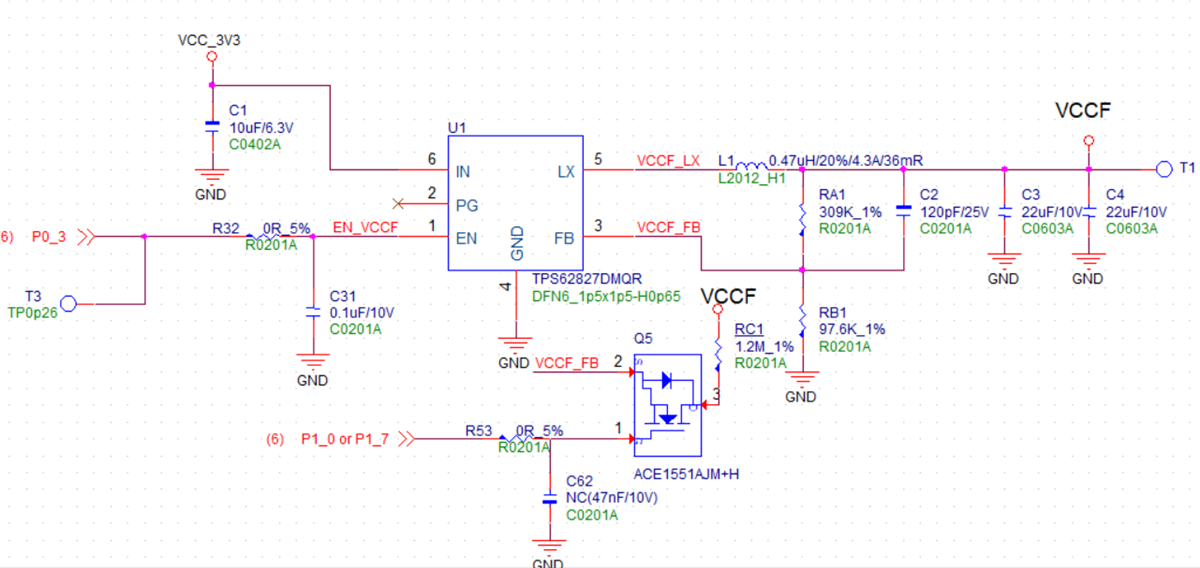

We want set 2 output voltage level 2.1V and 2.5V. We using N-MOS in parallel the resistor on FB pin, is it may have any side effect? thanks!
Hi Jeff,
Friday was a public holiday, so we can reply to your question now.
Yes, you can do this. Usually, the resistor + transistor goes from the FB pin to GND instead. See figure 3 in this app note: https://www.ti.com/lit/an/slyt777/slyt777.pdf
We also have the TPS62868 or TPSM82866C, if you want to adjust Vout with I2C instead.
