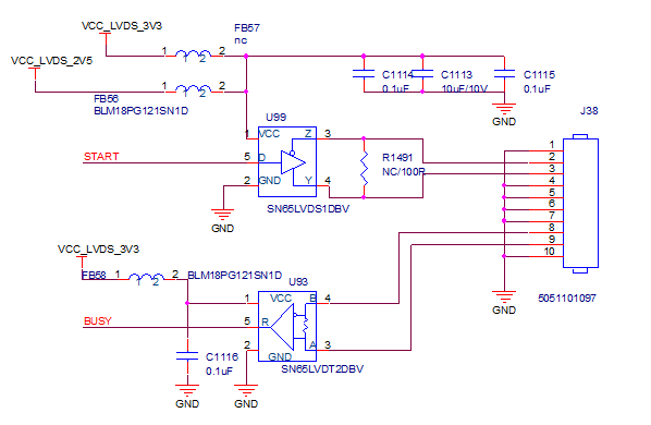

I'm trying to configure an LVDS2.5V interface using SN65LVDS1 and SN65LVDT2.
Would it be okay to use SN65LVDS1 (power supply +2.5V) and SN65LVDT2 (power supply +3.3V) to make it compatible with the LVDS2.5V interface circuit?

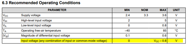

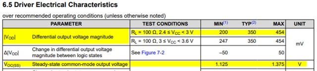

    Yes that will work. LVDT2 can accept any input voltage that is between 0 and Vcc-0.8 wrt GND. The max output voltage for LVDS1 is 454mV with a max common mode of 1.375V. That gives us a max single ended voltage of 1.375 + (0.454 / 2) = 1.602V, which is within spec.

    The basis for this are the highlighted specs below:
    If the Vcc of your receiver is 2.5V, that means any input pin on the device can withstand 1.7V since 2.5-0.8 = 1.7 (referring to the input pin spec). You can calculate what the max single ended voltage the driver will output with the following equation:
    max single ended voltage = V_OC + (V_OD / 2)
    This is the equation i used in my previous response to come to the 1.602V answer. Since 1.602 is less than 1.7, the device is being used within spec. Therefore this is a valid use case.
