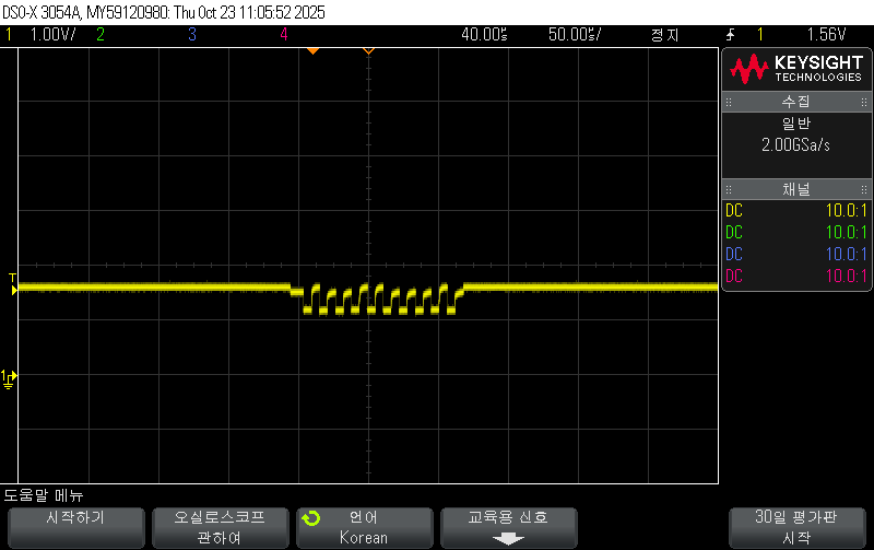

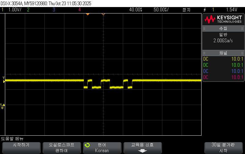

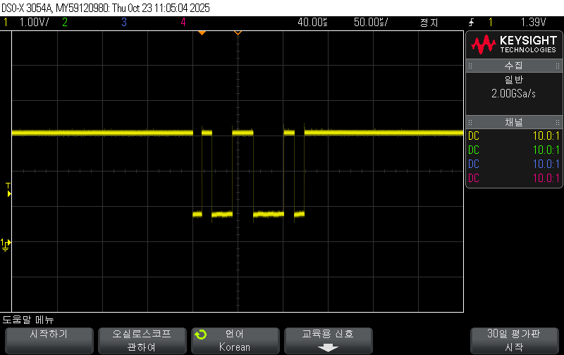

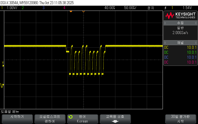

However, on the oscilloscope we observe:
  • 3.3 V side: 0.7 V ~ 3.3 V swing
  • 1.8 V side: 1.0 V ~ 1.8 V swing
In other words, the “Low” level never reaches 0 V but stays around 0.7–1.0 V, so I²C communication fails.

When the same MCU and I²C device are connected directly (without TCA9406), we get clean 0 V ↔ 3.3 V waveforms, confirming that the issue only occurs with the level shifter inserted.

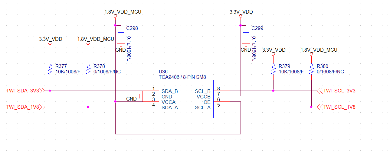

  • Hi Junyoung,
    Are the circled resistors 0 ohms?
    That would be most likely the cause inability to pull LOW.
    Tyler
  • I have tested with both 4.7 kΩ and 10 kΩ resistors for the mentioned parts, and also tried adjusting the values of R377 and R380, but there was no improvement. The IC shows severe heating under all conditions.

  • Hi Junyoung,
    10 cm trace should not have an effect at such slow I2C speeds.
    I reviewed the circuit, and have we confirmed that 0 ohm resistors are not being used?
    You commented on R377 and R380, but not R378.
    Can you confirm that all PU resistors are correctly valued?
    The schematic looks correct, but there are clearly 0 ohm's in the schematic unless I am reading it wrong.
    What other devices are connected to the TCA9406? This is a pass through device. The pullup resistors on A-side and B-side will appear in parallel. Are there any I2C buffers in the system? Buffers like TCA9517/TCA9517A/TCA9617B/TCA9803/TCA9509?
