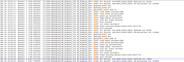

    1. The entire processing flow is to wait for fpdlink connection after the video output is stable, initialize ub947 first, and then initialize ub948. After determining that the resolution of the video obtained by ub948 is normal, initialization is complete. Afterwards, the running detection module first reads the registers of ub947 once per second, and then reads the registers of ub948. Only after successful reading will the log be recorded. From the log, it can be seen that after the exception of register 0x5A in ub947, the value of register 0x1C in ub948 can be obtained.
    That is to say, after reading the state "fdplink not read" from register 0x5A of ub947, the state "deserializer not locked" from register 0x1C of ub9478 can also be read

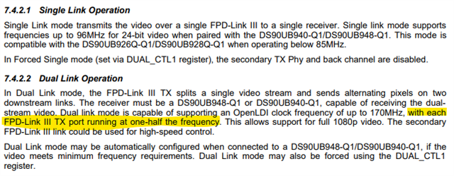

    6. Is the high-frequency frequency transmitted on the twisted pair cable consistent between the single channel transmission mode and the dual channel transmission mode of fdplink with the same video parameter input?  I am currently using the dual channel mode, can changing to a single channel reduce the frequency of high-frequency signals on the twisted pair cable?
    By using dual channel mode, you are actually splitting the frequency between two channels, so switching it to single mode will actually cause the entire frequency to be concentrated on a single link.

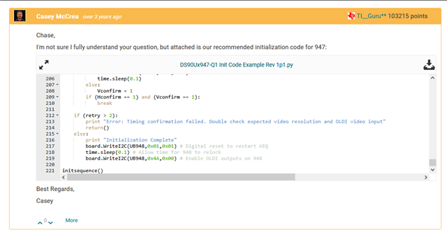

  • Hi Esther,
    1.
    I refer to the documents DS90Ux947-Q1 Init Code Example Rev 1p1.py and FPD-Link_S90Ux947-Errata. pdf, and configure them according to actual usage.
     RE: DS90UB947-Q1: source code or script when the link is unstable
    I have analyzed the log information of the recently problematic vehicles and found that 4 of them reported FPD3_LINK_RDY=0. When ub947 malfunctions, 0x5C=0x4d; Normally 0x5C=0xcd. Only when this car reports this error, can it still read 0x1C=0x32 from ub948, indicating that De-Serialize not locked.

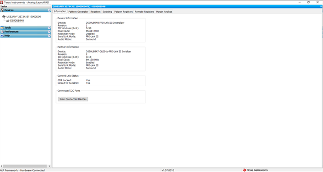

    3. I used map analysis in a normal system and found that everything is green. Is this normal?
    UB948 default map analysis configuration
