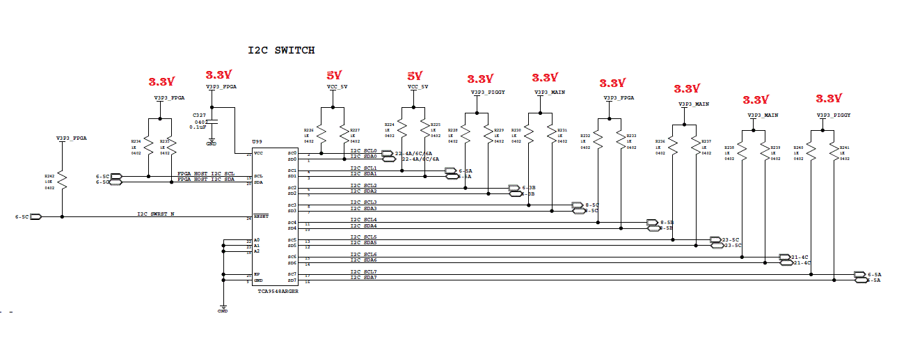

TCA9548A: I2C Switch application with different voltage
Part Number: TCA9548A
Hi Arya
I am just asking if I connect VCC with 3.3V then can we use Downstream ports (Slave I2C Ports) with 5V device (Pulled up with 5V) and 3.3V devices (Pulled up with 3.3V)
Upstream (Master I2C Port) port is connected with 3.3V device (Pulled up with 3.3V).
Pls see below sch image for reference.
