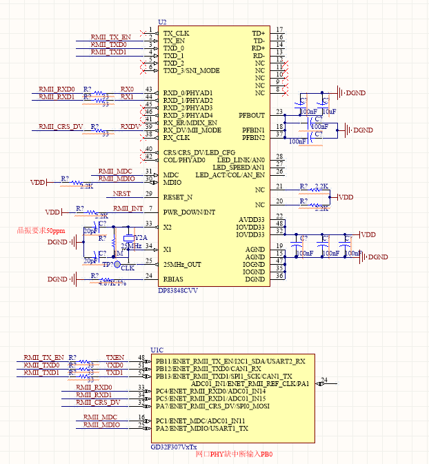

The following is the schematic diagram of DP83848C. Please help review it. Thank you.

It is policy for Ethernet team for customers to evaluate against our schematic checklist. I have attached a copy below. This is a easy-to-use document compiling the best practices for designing with the PHY collected over the years. If there are any further questions that this document does not answer, I can happily assist further.
Off a quick spot-check, I see that there is no MDI connection available in the current state. I would recommend adding in the MDI network for pins 13-17. In addition, DP83848 is only capable of RMII Follower/Slave, so there needs to be a 50MHz as the clock input attached to the PHY that is synchronous to the MAC's reference.
