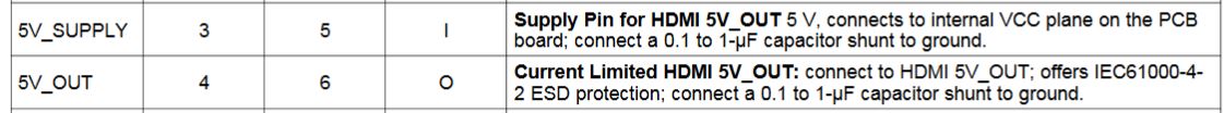

Dear Sirs,
My customer asked us about behavior in short mode of TPD13S523 .
I found the following description about the short mode of 5 V OUT and GND.
The short-circuit protection at 5V_OUT ensures that the device is not damaged in case there is an accidental short to GND.
So, what happens to the short mode of 5V_OUT and Power Supply(VCC Voltage)?
Y.Hasebe
    For the TPD13S523, the protection is only rated for the instance where the GND is shorted to the 5V_Out. In HDMI interfaces, pins 17 (GND) and pin 18 (VCC) are close together and have the possibility of shorting in the case the pins are bent when plugging in.
    The 5V_Out is connected to the Supply (VCC) through the load switch as shown below.
    The below snippet also shows how the two interact within the device.
    I hope this helps!

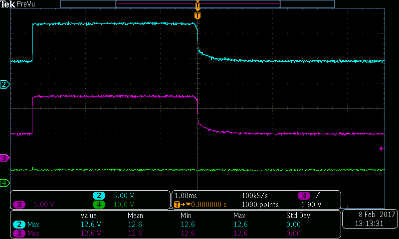

  • Hi Hasebe-san,
    After running a quick test in the lab, I do not see any effect on the V_supply. This test was done by shorting a 12 VDC source with the 5V_Out pin of the device. Below, the blue waveform is the voltage level on the shorting board, the pink is the voltage level of the 5V_Out pin, and the green waveform is the 5V input voltage of the system.
    This does not indicate any issues when the 12 VDC is shorted to the 5V_Out, but due to the lack of information in the datasheet pertaining to this event occurring, it can't be guaranteed as an intended function. I hope this helps!

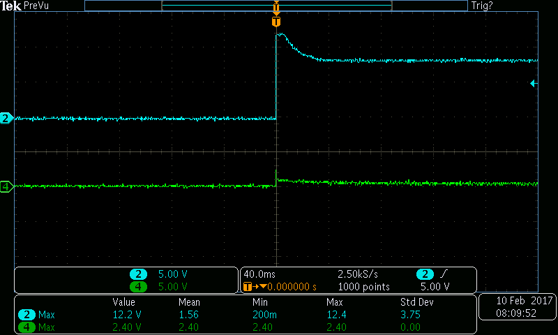

  • Hi Hasebe-san,
    After a second round of testing, the following waveforms are not showing any issues with respect to a prolonged short condition. The first test is done with no voltage at the source, the green waveform, and a 12V short, the blue.
    For the second test, the source is powered up with 5V and the response of the system is acquired after applying a constant short. There were no issues seen here either.
    As far as the testing setup, we are using a multi-channel DC power supply,  a short to VBUS board with VBUS set at 12V and an HDMI product EVM (TPD5S116) with the same power protection as the target device.This EVM boardt can be found on TI.com. I hope this helps!

    2.As your test data 2,
       1) In the first test, a voltage drop (about 4 V) occurs in the short circuit, and then it seems to be maintained at 8 V.
       2) In the second test, a voltage drop (about 2 V) occurs in the short circuit, and then it seems to be maintained at 10 V.
    What are the causes of the above?
    Also, is there no problem if this situation lasts for a long time?
    It seems from the data sheet that ZenerDiode between 5 V - OUT and GND is on.
    Y.Hasebe
  • Hi Hasebe-san,
    These voltage levels are due to the clamping voltage of the test device. The level increases with current and because in the 2nd test we have two sources on, we are seeing a higher current level. Thus, when the circuit clamps, there is a slight change in the voltage clamp level.
    As far as the test setup, we are powering the 5V_sys off of the VCAA voltage @ 5V and the 5V_CON from the V_CON. The 12V is introduced on the middle pin on the CON side. you are correct. Before applying the 12V, ensure that you have 5V on both the SYS and CON.
    Hope this helps!
    -Brian
