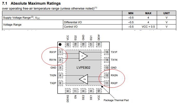

Please let me confirm the abs maximum rating of differential input. I understand that we can apply less than 4V on differential input when there is no Vcc. Is my understanding correct?
Satosni
Satosni
Hi Satosni,
Yes, the input amplitude absolute maximum values are -0.5V and 4V. If the device is unpowered and the common mode is at GND potential, the -0.5V number could be exceeded with an input amplitude > 1V
